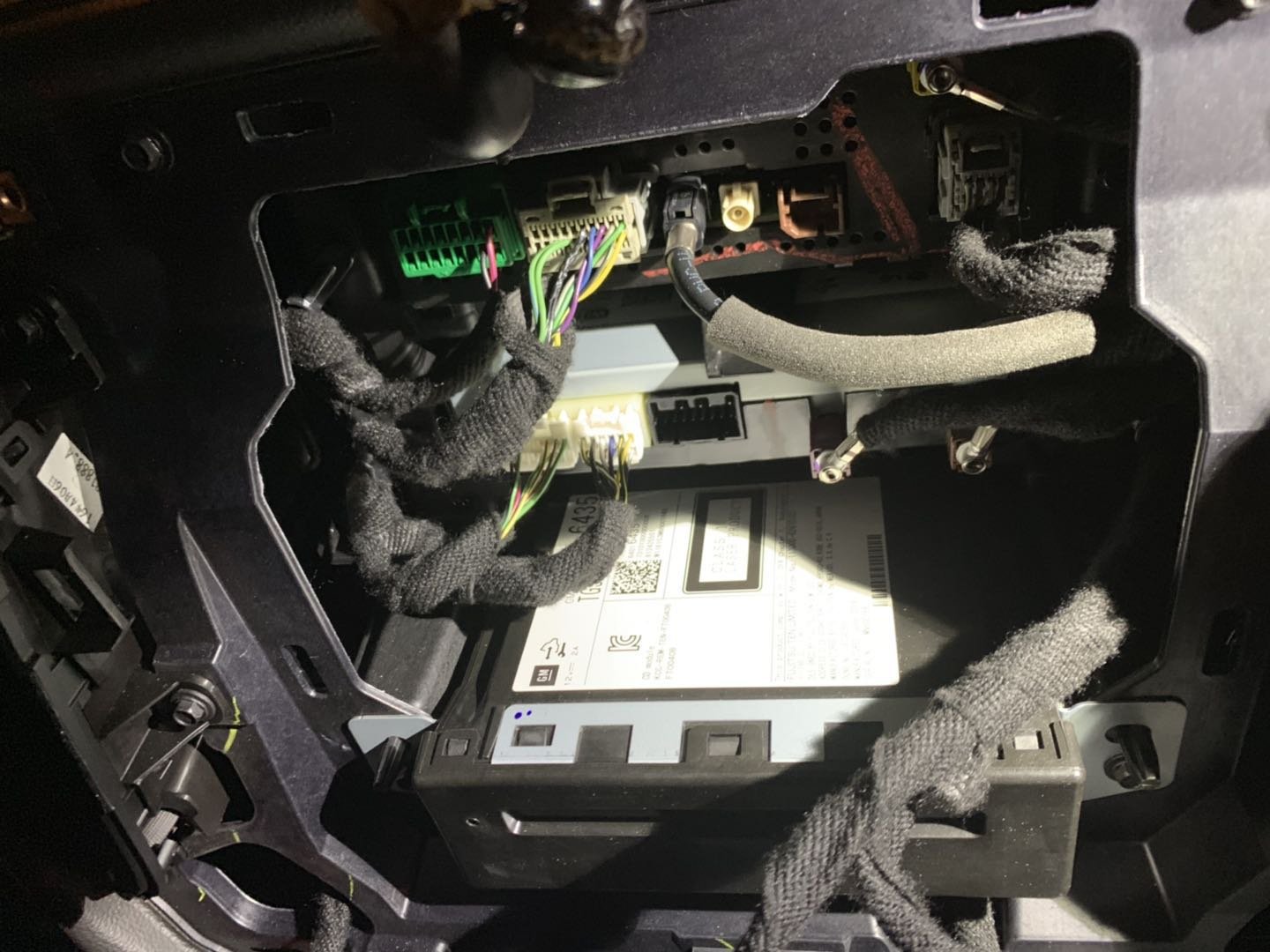

I have a 2016 silverado 1500 LTZ,  I want install a Line out converter for my subwoofer,  but with BOSE system. I want know what colors is front speaker wires,and rear speaker wires.
Contact llj customs. Tbey have a plug and play module so you wont have to cut anything. If i remember right its like 120 bucks
Well first thing first. You are in the wrong end of the truck. You need to go to the amp on the rear wall passenger side. Or pick up the wires in the sill panels.

So I can tie into the speaker wires at the B pillar and run them to my LC2i? I don't wanna take my back seat out of the truck. The lc2 says it can handle a amplified signal so it shouldn't matter what side of the bose amp your on. Correct?
