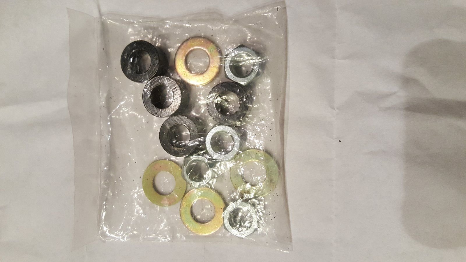

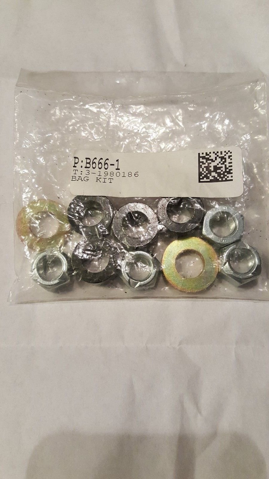

What are people using for spacers? I have seen the small metal washer style ones that mount at the top and then the brackets for the bottom.
Thinking the washer style on the top will be the most robust? I have a 2016 2500hd with stock keys turned up about 1.5" and bilstein 5100 which currently limit the drop.

I have a new in pack set of the front shock ext. if your interested.  will let them go for $15.00 shipped
