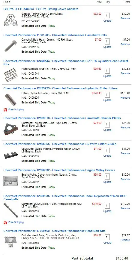

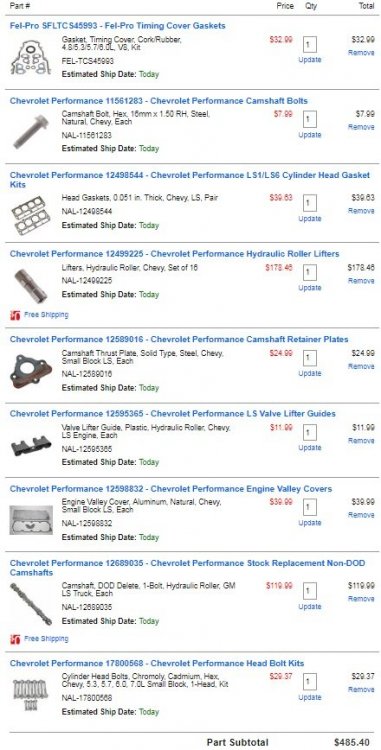

While your at it order another $485 in AFM delete parts and have a nice runner.
Delete

I saw those. I keep checking that delete kit out too, I lost #4 intake lifter about 20k ago. I know I cheaped  out but I just replaced the one and not the other three and had her back on the road the next day for about$150. It’s worked so far, knock on wood. It’s going to wind up being a choice between a reman shortblock or a 100k mile complete salvage yard motor. Looks like you come out about the same in the end
