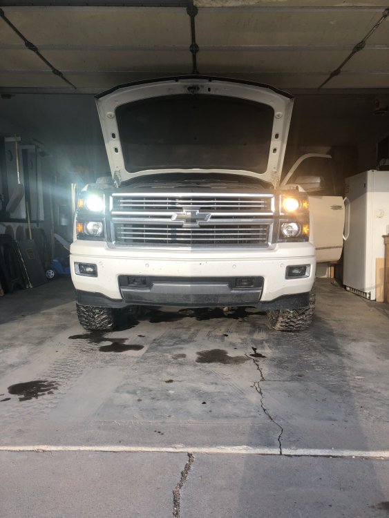

Thanks for the reply.
I tracked it down to a bad bulb also. The retrofit source is awesome and are sending me a new set of bulbs free.
I switched every possible part from the drivers side to the passenger side. The bulb was the last part I switched because of the air box.
The running lights were burnt out also.
its weird everything went out at once.
For now I have one hid and one stock bulb. It’s amazing the difference the hid kit makes!
