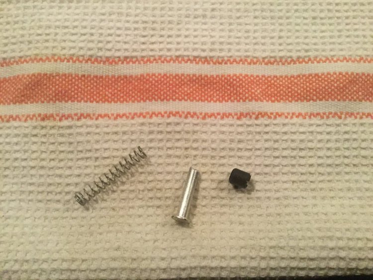

txab Posted April 10, 2019 Share Posted April 10, 2019 (edited) What parts did your "kit" include? You still may be missing some pieces Edited April 10, 2019 by txab Quote Link to comment Share on other sites More sharing options...
CraigMac Posted April 10, 2019 Author Share Posted April 10, 2019 Hi, thanks for replying. I picked up a horn replacement kit because I thought that was all I was missing to get the horn to work here’s a photo of the three pieces that it was made up of... Quote Link to comment Share on other sites More sharing options...
CraigMac Posted April 10, 2019 Author Share Posted April 10, 2019 Also Thanks for the diagram. I have a Haynes manual but it didn’t have this in it. I will look it through to see what’s what. Quote Link to comment Share on other sites More sharing options...
CraigMac Posted April 10, 2019 Author Share Posted April 10, 2019 i think I need to remove steering wheel to access the turn signal cam so I can then insert the pieces above ...Spring, insulator , etc for the horn. Is that about right? Up to now I had not removed steering wheel. Seems that’s why I can’t get the insulator to fit correctly Quote Link to comment Share on other sites More sharing options...
