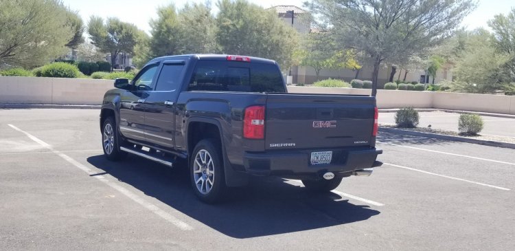

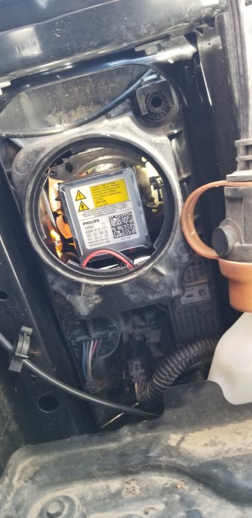

My issue is with factory HID lights.
What truck do you have?  Im wondering since this is more than just an isolated case, its actually NOT my aftermarket kit.
I have Intermittent problem, and it's only the headlamps no other lights. They come on flutter and go out, both at the same time. Or they come on stay on and work fine. Auto or manual makes no difference.  BCM module has been replaced and programmed, no help. Truck is 4 years old but only has 21000 miles. Warranty is gone I'm second owner. Headlights is the last thing I ever thought would have a problem. I have no problems with anything else on the truck.
1 hour ago, VRoque said:
Hmmmm. Wonder if its because its a Denali? The lower trims have halogen. My next door neighbor has a 15 slt with premium plus and he has halogens. And im 100% sure on that. Because his was one that the dealer changed the bulbs out for the brighter ones. Thank you. I learned something..
But still, there is definitely an issue. And its not the bulbs, ballasts, or wiring. Yours and mine are pretty different as yours are factory, mine are aftermarket, and we have the same problem. I replaced my headlight switch for the off road lighting option and I cant remember if its done it after that.
