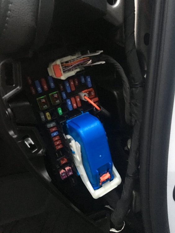

There is a lug on the pass side fuse box that is ignition only with retained accessory power as well. I wired my CB to it. It’s next to the 50a fuse. If you use it make sure your wire is fused!
Here’s a pic...

What type of tap are you using in that pic?... looks nice to have
It's not a tap, it's a female spade connector.  Plugs right onto "male" lug in the fusebox.  Super easy.
