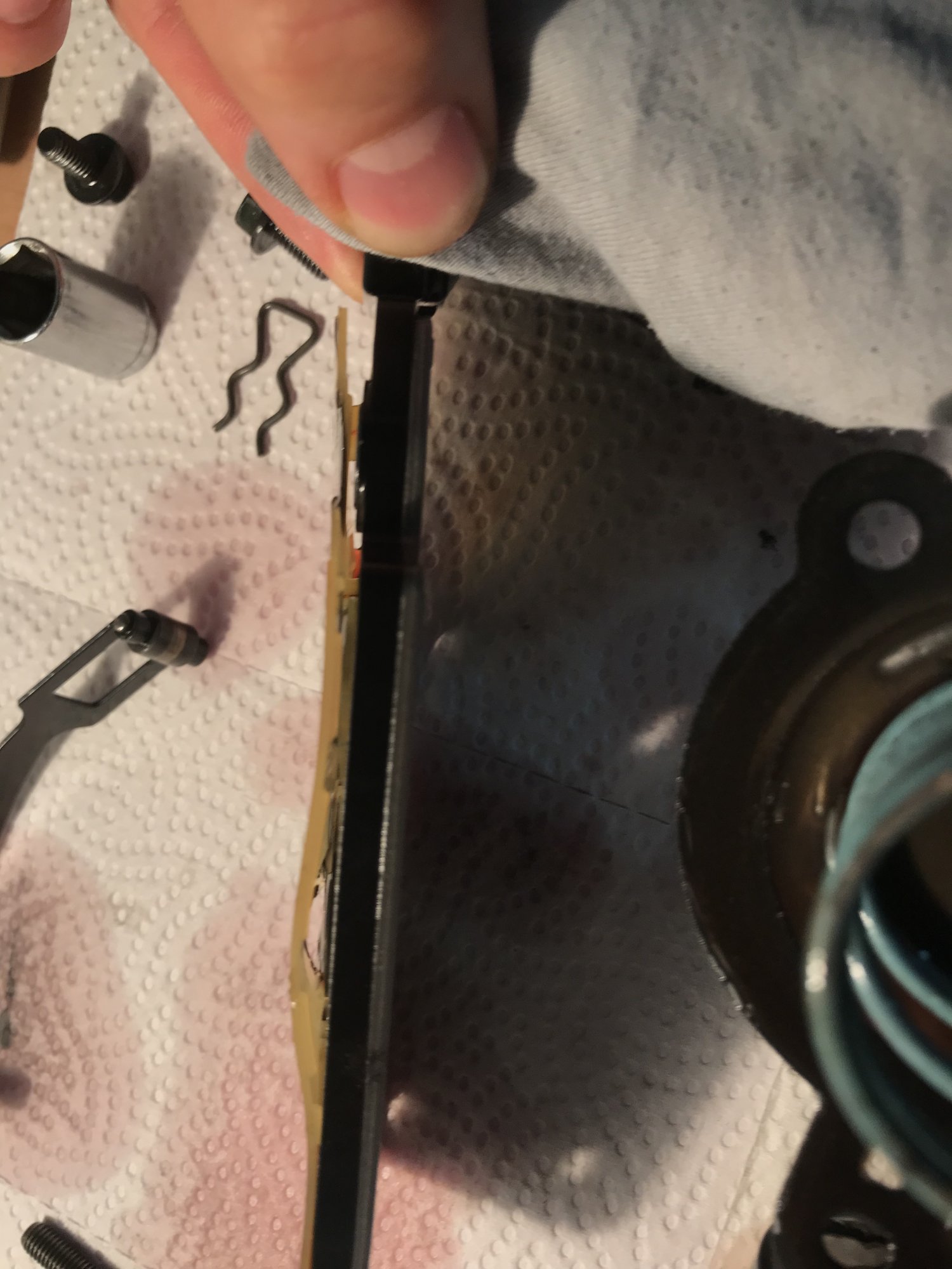

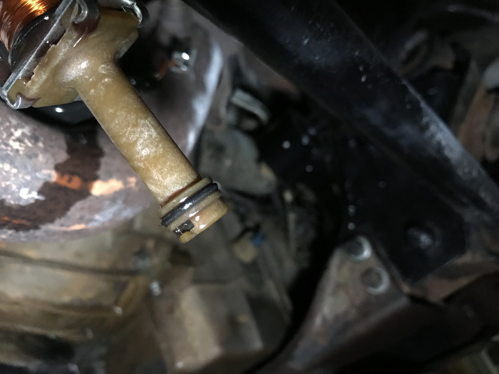

Have my valvebody disassembled today.
Habe few new questions:
1st: do I need a new pressure valve manifold? See pictures.
2nd: do I need a new oring for the tcc silinoid?
3rd: do the oil filter need a new ring or bushing where he is fixed?
4th: I have this dipstick holder not die pen with the egde. How deep should the dip stick goes into the pen? My stick ends right when he comes out of the tube and goes only half a centimeter into the oil pen.
1-3: No, but it doesn't hurt to replace the orings. As long as they're not scratched or cut, you can reuse them.
4: Dipstick is fine. That's how its supposed to be. Just be sure that the small metal clip that bolts on that corner is present, unless you have the crimp in the oil pan on that corner.
There are 4l60e valve body rebuild kits that include all the parts typically recommended.
New valves, orings, check balls, etc. Suggest putting one of these in to get all those components that might look good but are border line.
