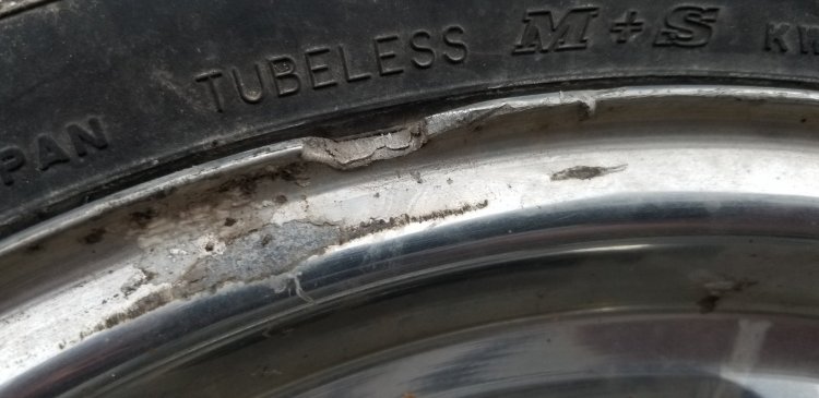

Damaged Wheel
I'm going to get new tires soon.  Think the tire place will have issues with this damage?  Wheel doesn't appear to be bent.
Those are not an issue.
The rims don't seal to the bead of the tire there, it's not going to cause a leak at the moment. Though in time, if you live in a place with salt, it can be a spot where corrosion is able to start. At least on the first picture.
You could ask them to really clean it up and apply some bead sealer to the area to help protect it.

If I had a shop I’d be reluctant to reuse the wheel for liability reasons. Those steel rims are cheap enough, so why not just replace it?
