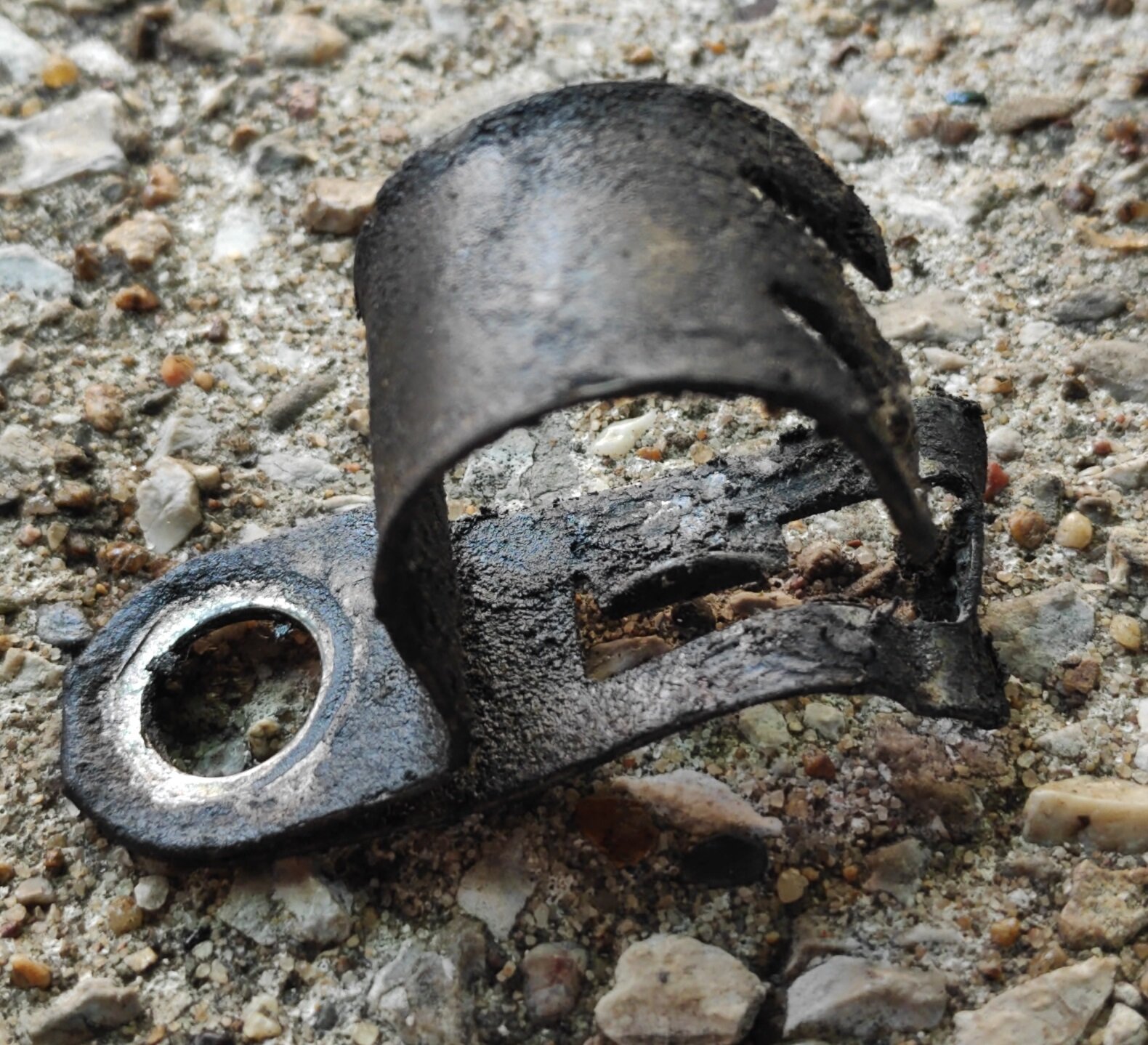

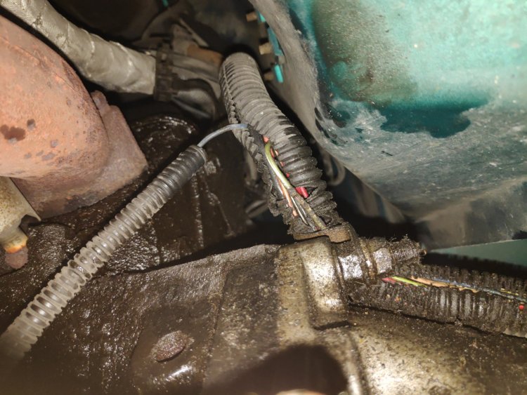

well i may of fixed one of the problems i was having. Today i decided to put the original solenoids back, while i had the pan off i inspected all the wires inside the transmission and they all looked just fine, nothing was worn, brittle or exposed, and none of the connectors were loose. so i put it back together. after i had that finished i inspected the wiring leading out of the transmission, well there is a clip that bolts to the bell housing near the engine that holds the transmission harness wires in place. I noticed the black loom tubing that goes around the wires was very weak and falling apart near that clip i removed the clip and found the clip had worn through the loom and jacket of the green wire and was making contact with it.
i wrapped everything with a thick layer of electrical tape and bent that clip into a more friendly shape and put it back.
the fuse is no longer popping, and the truck seems to be driving and shifting fine now..
