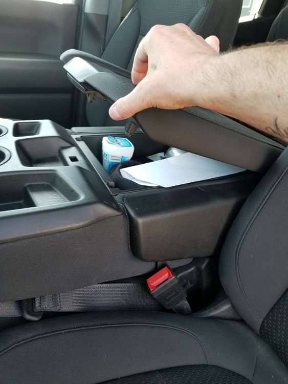

I'm looking to swap out my jumpseat in my 2019 TrailBoss ,custom. It is useless and I am in dire need of that additional storage area. Any ideas?
Thanks for your time.
Here's the thread that gives all the info for replacing the non storage jump seat arm rest top, to the one with storage.
Skipping ahead to page 7, Jeffed's post on June 13th, you'll see the part number for the armrest. (Top seat portion) 84647286
Then on the next page, you will find the clip part number, which you need 5 each of. 11549266
Big time thanks to Jeffed for posting his results, along with the PDF document he posted on June 13th as well.
IMO, this is quiet possibly the most epic "must do" mod on Custom and Trailboss Custom's, short of the exhaust mods.
Pic that I attached is from that thread.
Hope this helps.
-Patrick-

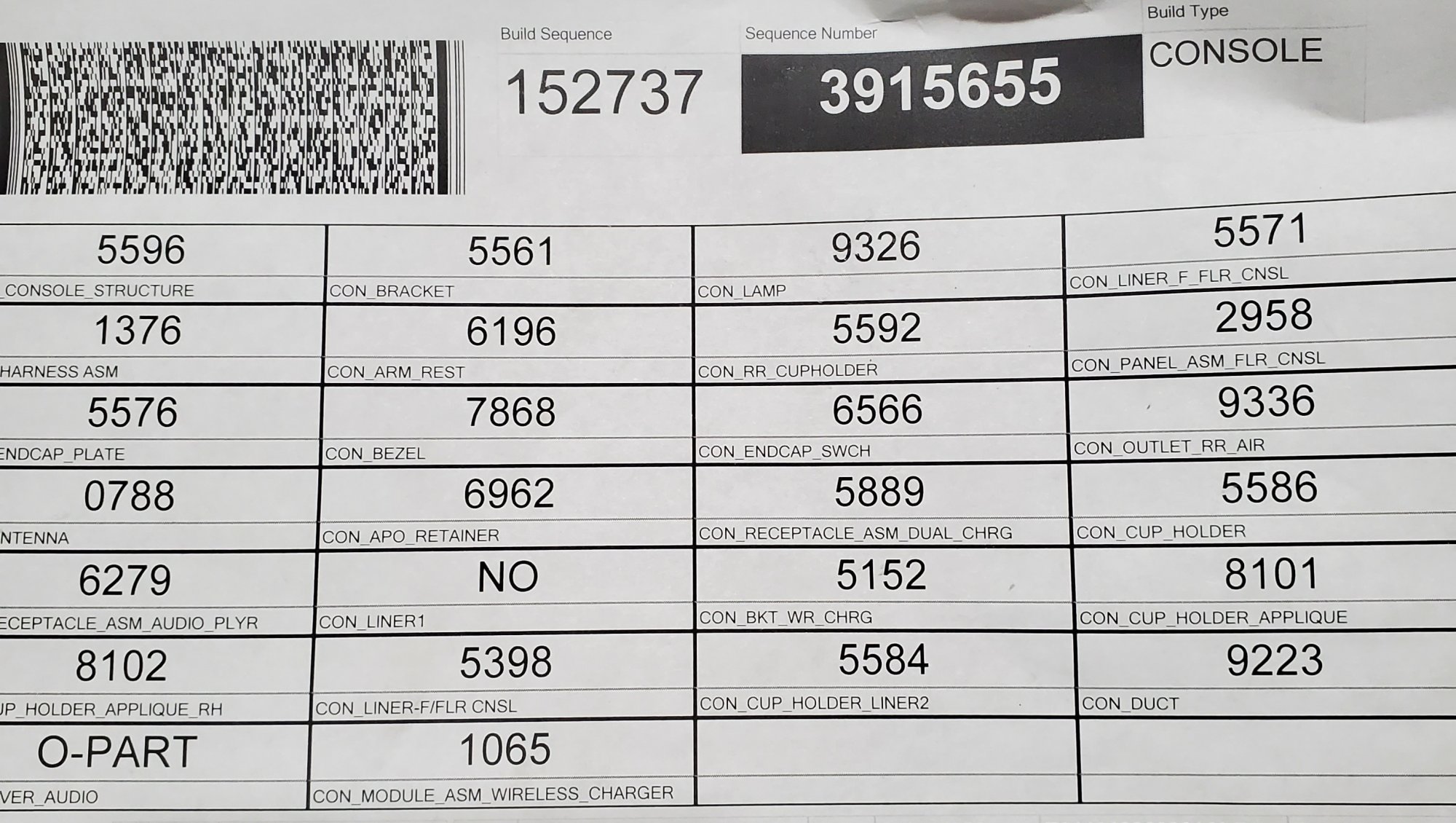

Hey all, I just installed my new console in my 2019 custom TB, it was out of a 2019 GMC 1500 Denali. I was able to get one from G & R Auto parts out of Oklahoma City. It took 30 mins for the full swap, the pain part is you have to remove both driver and passenger seats to get the back bolts out of the jump seat. There is no wiring harness yet or updated module but the guy who I talked to from harness doctor said earliest is late this year. It's a whole different pin connector, intergrade wireless charger, SD, 4 USBs. I'm nixing the rear heated seats. All I need is the new trim to match my gunmetal that came with the truck. Any ideas? I was thinking painting or wrapping for the temp the dealer wanted way to much.

Adding parts brake down list for reference
