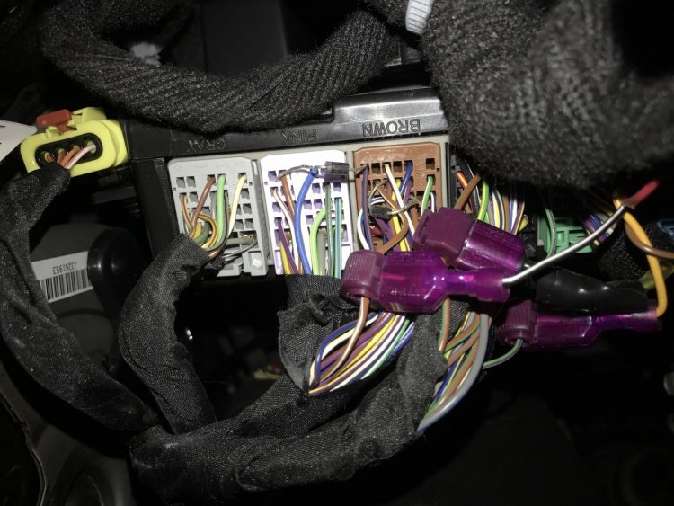

Did you do the cargo/reverse diode mod?  Or did you only change the bulbs over?
I'd start by undoing your cargo/reverse work.  Run that way for a while, to see if it was or was not your bulbs, somehow.

Where can I adjust the camera delay, and what is the diode mod?
The attached picture is from my '15, all forward facing white on with HIGHs (BRN10 to BRN18), all rear facing white on with Reverse (BRN26 to PNK26), and Puddle lights on with doors open (GRY1 to GRY8).  My '18 comes with the puddle light coming on with the doors open.  My '15, when I did the diode mods, the puddle lights would even come on with I turned the interior lights on.
(Striped end of the diode is in the second pins identified above)
