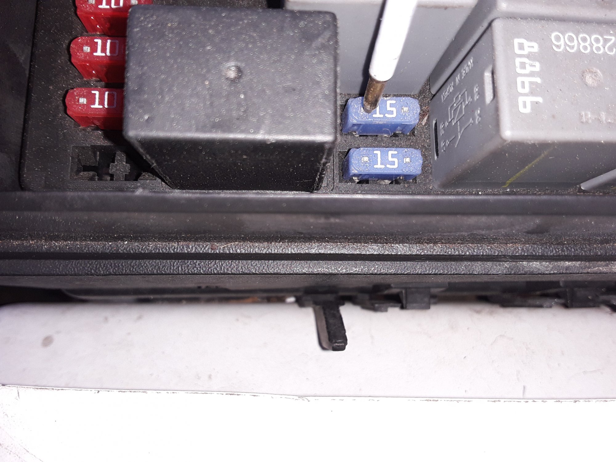

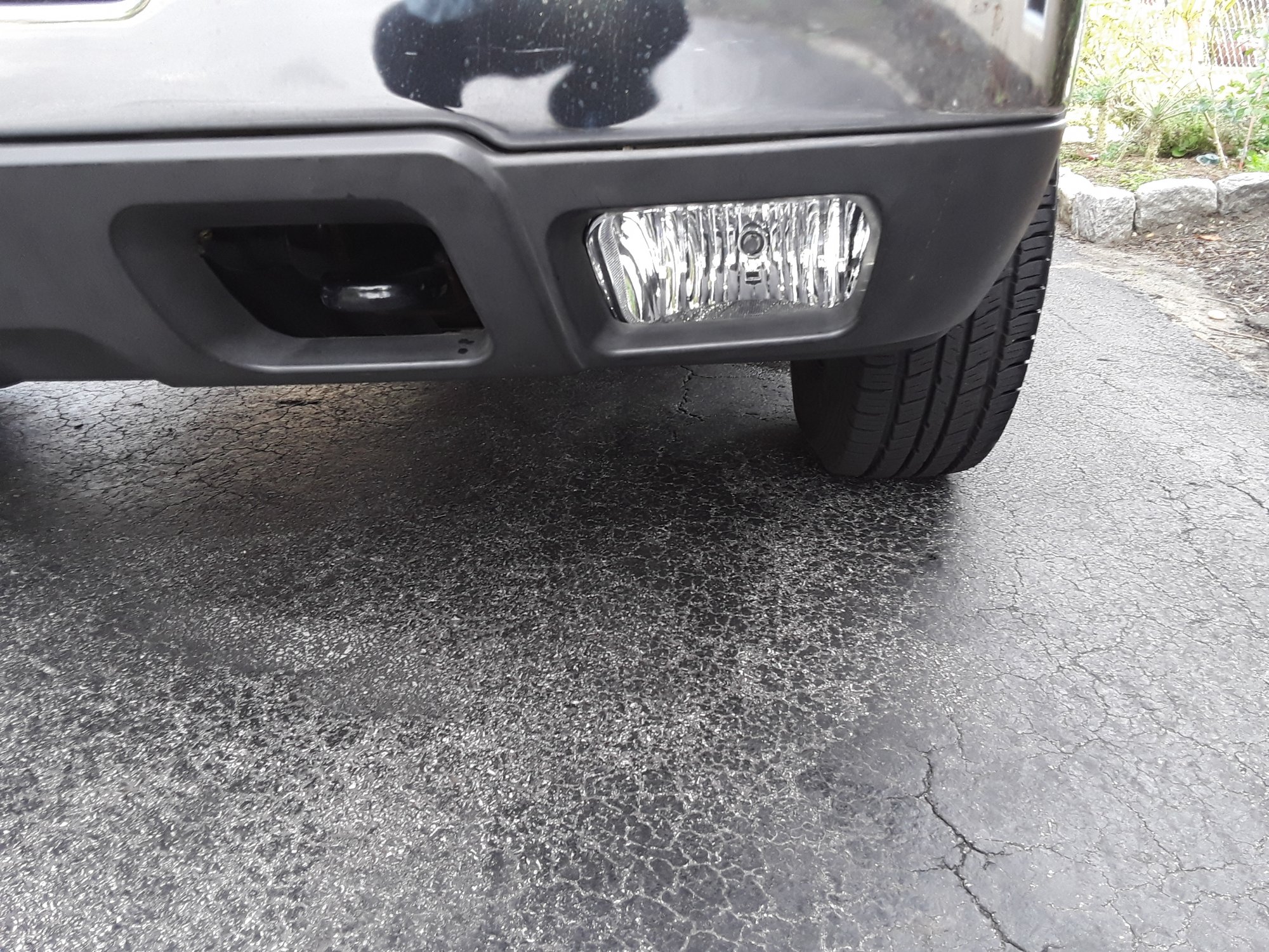

the fog lights were pretty easy, stock dash switch plugged right in, bought the fog lights on amazon, hardest part was tying in the wire harness to the fuse box under the hood, taking the fuse box apart.
fuse box wasn't very difficult, used a stock connector i got from scrap wire at a dealership  a mechanic let me look through
seems i forgot about the relay, sorry installed the fog lights in 2014. heres a schematic of the wiring.
