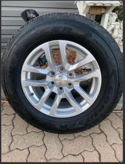

I'm trying to find a set of o.e.m rims to mount some studded winter tires on. I understand that the 2019's have larger calipers, and earlier rims will not clear. What about other 2019 silverado, or at4 wheels? I've attached pics of 2 sets I have found local. Unfortunately, I only need the rims, and these are rim tire combos.
^^^ What he said, just add the words new body style.  I would guess 19 legacy rims would not fit 19 new body style trucks.  GM really screwed up with the 19 legacy, just sell them for what they are, left over 18s.
This is what i'm afraid of. I don't know the difference. The picture with the rims on the truck, it looks like that truck has the new calipers. I can always test fit before purchase also.
The truck in the photo is the new body style, and those are new body style 18” rims, found on LT, RST and LTZ trucks. They will fit perfectly.
