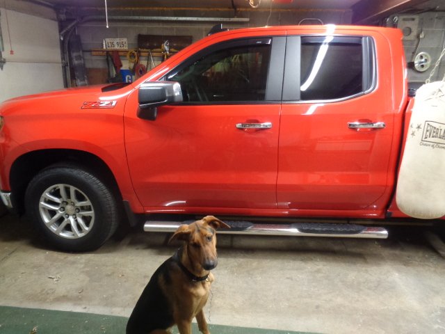

We'll see how it goes,found a guy with a full set of chrome take offs for $100.That beats the dealer price easy,I'll find out if it's similar to the 14-18 models and plug and play.
I've seen the schematics - can't remember where though. It is just as easy. Only difference is a plug that disconnects. Otherwise the swap out process is the same.
Some may not like the look.Switch was pretty easy,hardest part was figuring out how the plug came apart.Take the door panel off(5 screws on the front,4 on the back,one behind the handle,two behind the armrest,one or two at the bottom) and carefully pop the clips off,peel back the water shield, the connector has a small red L shaped slide first and then a built in spreader that you depress and you pop it apart.Door handles remove easier than the 14-18 ones,no fishing line required to reinstall,they just push back in,and tighten the #25 Torx bolt.
