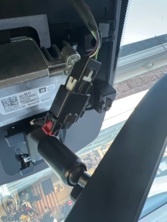

Is this (pic below) the mirror connector to tap into for a radar detector? And how do even pull this connector apart? There has to be an easier way… 2022 GMC Sierra.
That's not the connection I used on a 22 Denali.
