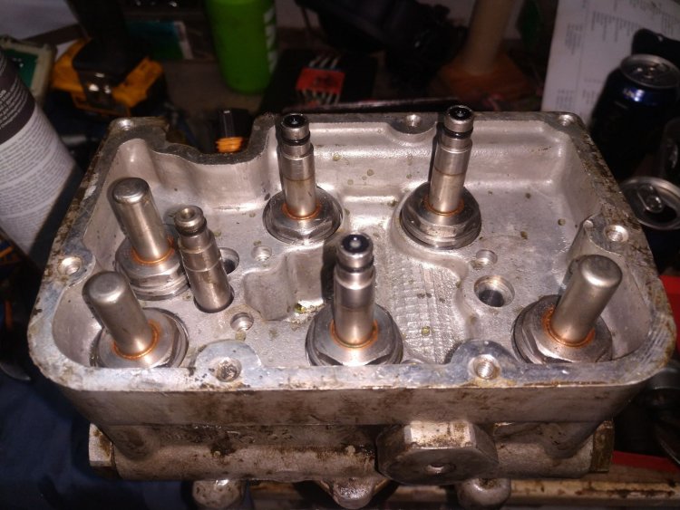

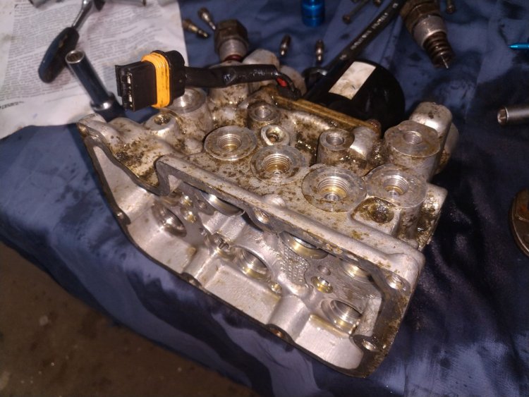

I was searching for a solution for my ABS problem that i have i my truck and didn't find much of an answer, some hints here and there what might be the problem,
So i decided to open up the ABS unit and just clean it with breakclean and compressed air,and also change the brake fluid before removing the unit, so when you put in the clean unit you dont get all the dirt back in the ABS unit
  1. Here's some pictures of the unit and a link that was helpful. hope this helps
http://www.remaninc.com/pdfs/gmtrucks4walabscodes.pdf
  • The ABS unit can be affected by contaminated brakefluid
  • after removing the bolts from the "gold" units use a grip tool to pull them out
  • NOTE Be careful when removing the electronics
  • Nothing special just remove everything now before the clean up
  • Nothing special about this picture just remove everything before the cleanup.
