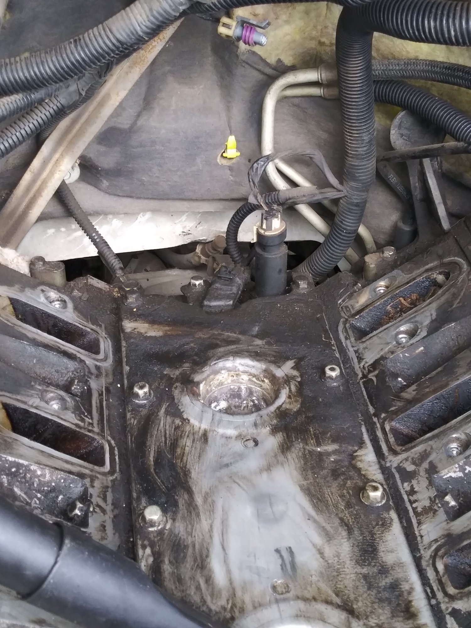

Hey im taking apart my manifold to change knocks and notice these two sensors in the back can any help me identify them? Thanks in advance
Sorry, can't help identifying them, but, how many miles on this engine?  What year is it?  Reason I ask is take a look at the crud inside the ports.  Are you trying to fix a trouble code?  If so, what code? That amount of crap attached to the intake ports is likely all over the underside of intake valves.  Fzke a look down the ports and see if it is heavily attached to valves.  It needs to be cleaned out.
The year of the truck is a 2001 Chevy Silverado and I fix most problems including knock sensors TPS sensor map sensor mass air flow sensor and still have sputtering issue when I smash the throttle. All intake ports are looking good cleaned out. I check for air leaks and still nothing can't put my finger to this problem

You need to stop diagnosis by wallet.  You will spend far more than you need. If any of those parts were failing you would have received a check engine light in the cluster.  If you are not getting a code, the problem is not likely in PCM controlled parts.
Check fuel pressure by connecting a fuel pressure gauge to your Schrader valve on the fuel rail.  You will need to find a manual to get the recommended fuel pressure under idling and snap throttle application.
You also need to check plugs, and only replace if they are required.
And stop throwing cash at it.
