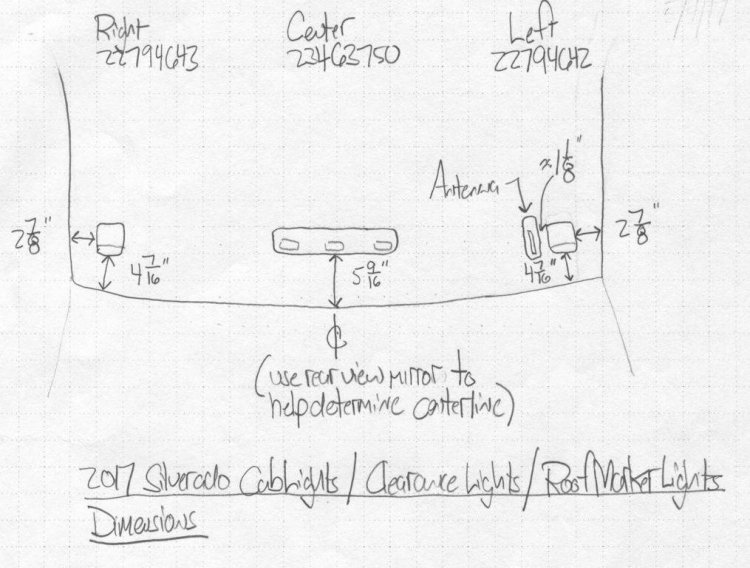

i am going to be adding the oem top cab lights to my truck and need to get the measurements for where to mount them does anyone have the measurements for the mounting holes for the 2 side lights and the center light TIA
I used to have the actual PDF of those measurements from GM....alas they're buried in the depths of my phone somewhere [emoji31]

On 4/18/2020 at 3:19 AM, rocnrol said:
I used to have the actual PDF of those measurements from GM....alas they're buried in the depths of my phone somewhere emoji31.png
Sent from my SM-N975W using Tapatalk
thanks do you know if these are the same measurements that the factory lights are at?
these are the measurements that I used and it came out perfect.
