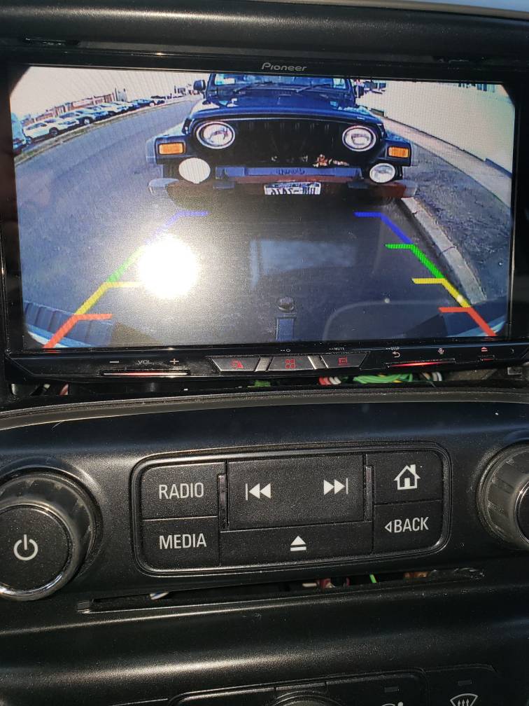

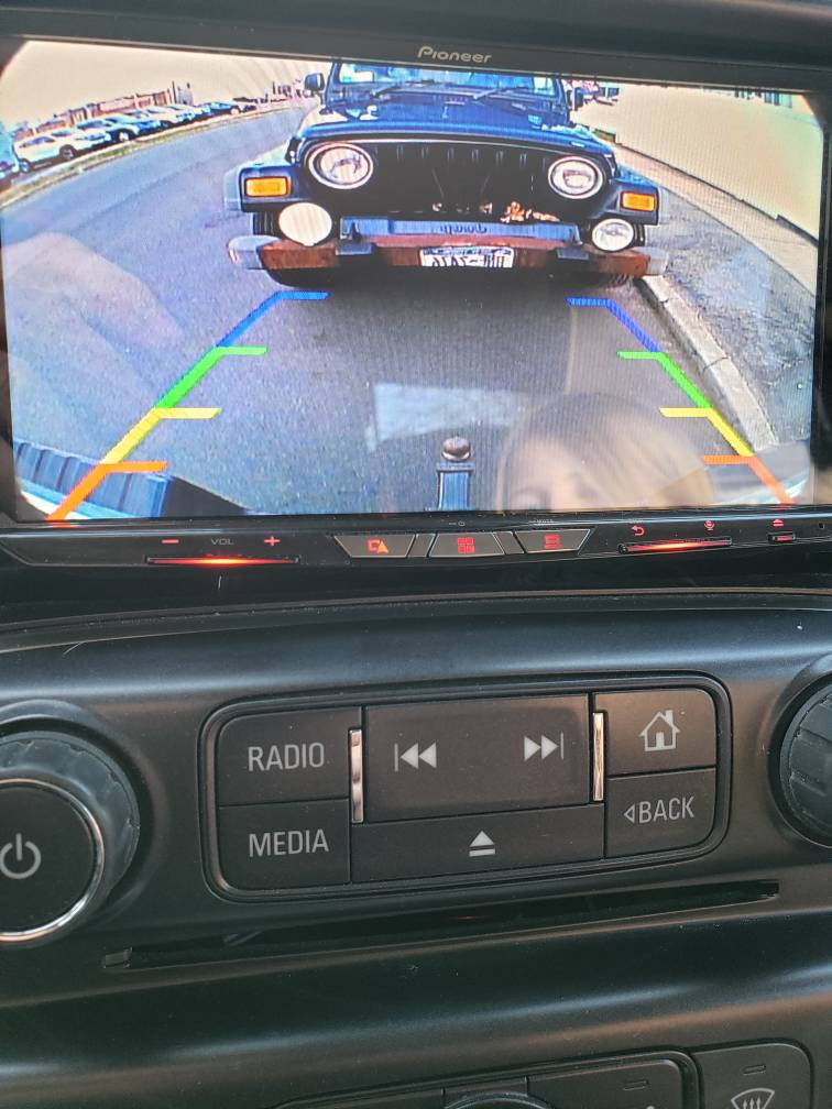

The radio might not have it built in. The avic7200 had when i swapped to the avic8400 it didn't. The factory camera doesn't have it built in. I am in the process of changing out the factory camera to a better 1
Sent from my SM-G960U using Tapatalk
Here is pic of stock and 1 with a roughly 600tvl resolution. Pic with lines is aftermarket camera. I have ordered another camera thats suppose to be 800tvl. Waiting for that to come in to compare.7b52a7f08f044ab1bf301b218e6a37b7.jpgbec0a2ff67a6a098c4b139c57e69e99f.jpg

I finally figured out the issue with the backup camera and got it to come up with right screen in reverse. Now the issue I have is that I must click the button on the screen to make the lines appear. At this point I’ll have everything worked out in a year.
