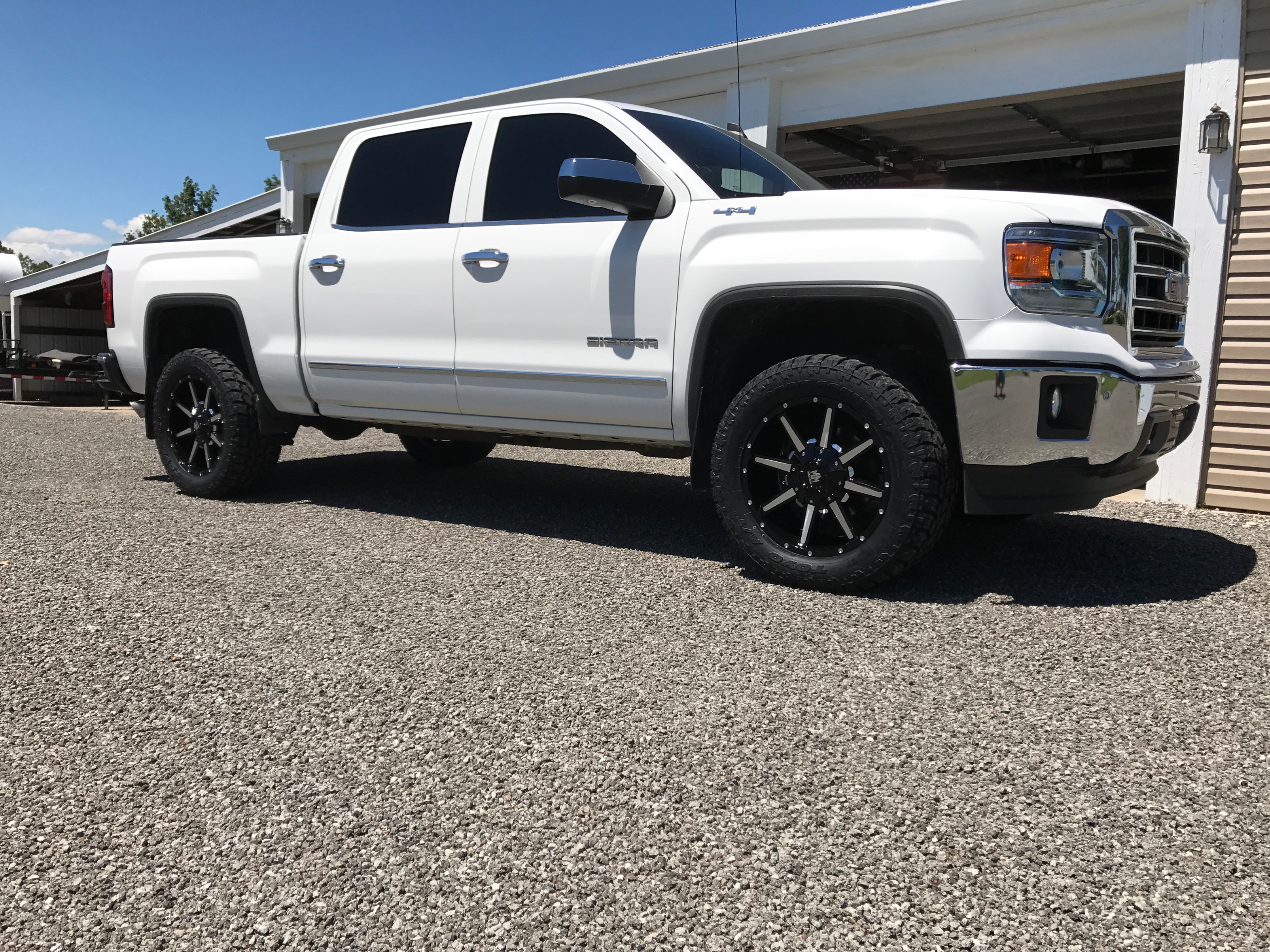

Same 2 inch level up front stock rear. 20x10 -19 wheels on 305/50/20 (~32) tires
Dirt king uniball upper control arms, King 2.5 coil overs with resis, 3 turns of preload (roughly 2.5 inches of lift over stock) 17x9 -12 wheels with 285/70/17 (~33) tires. Stock height rear with 2.5 king piggy hose shocks with extended travel.
0e950f408e41b7ebbe02f683dd443a1b.tif
I know this isn’t exactly what you asked for but it’s a few setups you can reference.

Me personally, I would think the 2 inch blocks in the rear might look silly with stock tires. If you surely want to lift the rear I think a 1 inch taller block would look fine with a 2 inch level up front.
MotoFab Lifts CH-1R 1 in Rear Leveling lift kit that is compatible with Chevy Silverado Sierra GMC 2007-2018 https://www.amazon.com/dp/B017WO6AVY/ref=cm_sw_r_cp_api_i_3x7MEbWXRV638
But it’s your truck, what I think is hideous could be your jam. Check out pictures people have posted in the amazon reviews. But my best advice would be to stay away from the 2.5 and 3 inch front leveling kits unless you do aftermarket upper control arms at least. Custom offsets website has a searchable gallery of modified trucks as well.

Here’s what I did. I put bilstein 5100’s all the way around with the front on the highest setting. I also had a 1/4 spacer under the shock from a previous level kit that I left in. I then added 2” blocks out back. I”be not had any issues with running or travel issues with my set up. Granted she stays on the pavement 95% of the time. My tire size is 295/55R20. When locked, there is minimal running and it’s only on the sway bar. It was cheap, easy and can be done in your driveway. Best of all, it gave me the look I was after.
