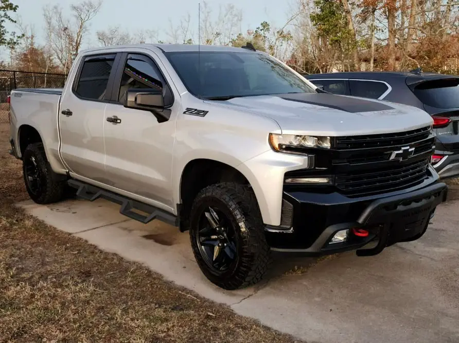

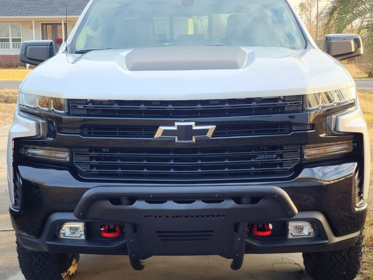

Turns out Shopchevyparts  was a great place to order. $573 total including ground shipping and a 5% first customer discount. Ordered on the 27 and it came today, early morning so enough time for the install. Instructions are included, but visual install on a '19-20 is best in thiks video using another brand. Pricey but one of the very few bars using a custom brackets for the '19+ that permit you to reinstall and access the existing tow hooks.
Only points to make is there is no way a battery ratchet removed the factory tow hook bolts.....I used a 3/8" air ratchet pressure pumped to 120 lbs and it couldn't break the bolts loose....needs a 1/2" breaker bar and 18mm socket. Real solid mount both the bar and tow hooks. And easier to remove the front plate to access the nuts on the mounting bolts and then reinstall the plate. Also added a piece of red plexiglass behind the hollow lettering. Now the sports bar, running boards and brush bar match. Install took almost three hours including a 1/2 hour rain break.
Nice look with the lighted bowtie and brush guard.
