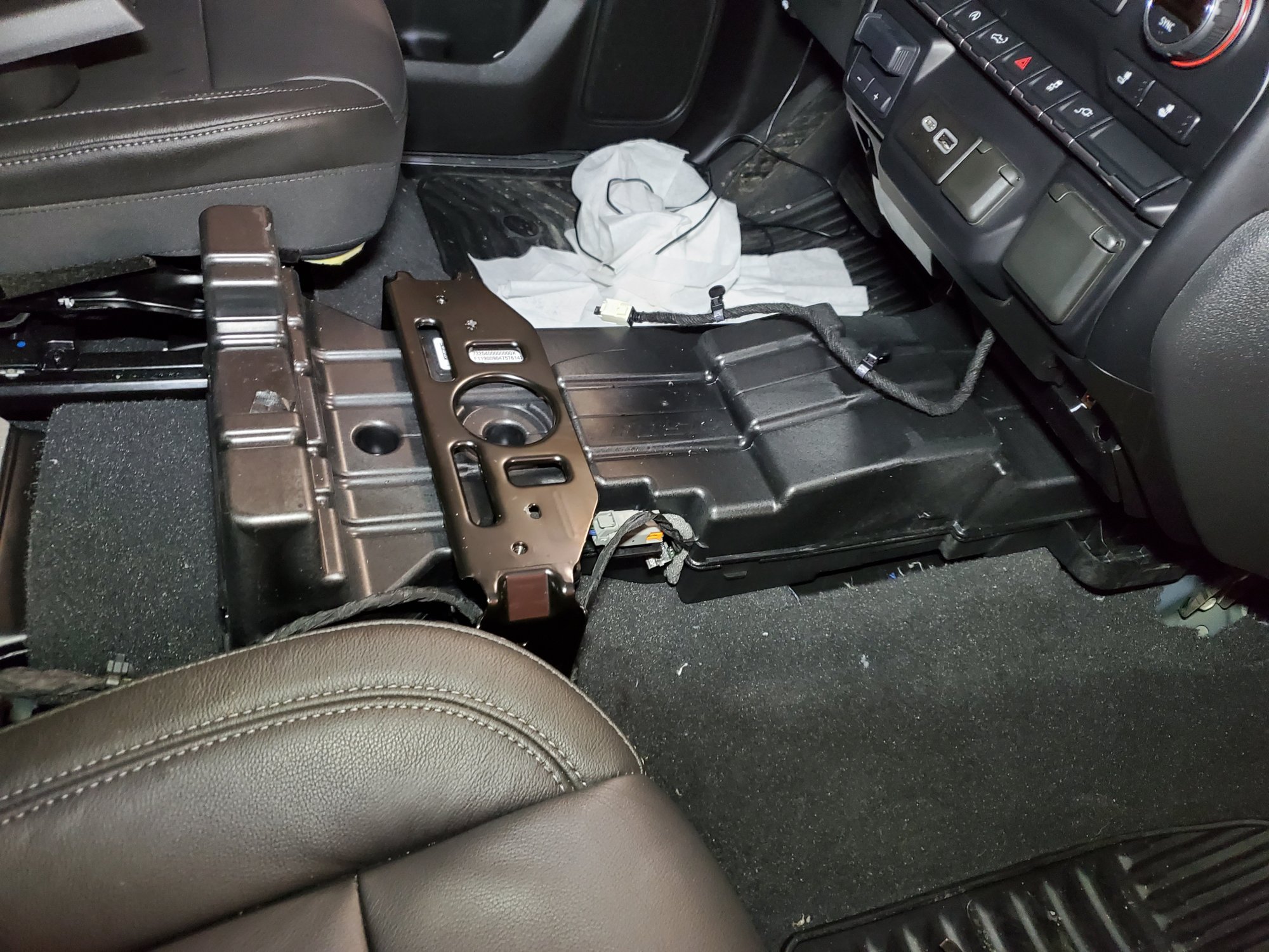

Just wanted to see if anyone has checked into DYI replacement of the BOSE sub in the center console?
Sub Part# 84507689
On 5/8/2020 at 9:13 PM, chadman said:
Interested as well
I pulled the console on mine to see if it was possible like on the previous gen trucks. Its not as easy. Many more things to work around and the box volume would be difficult to keep up.  Factory box is only about 4 inches tall at the thickest area so that presents several challenges
