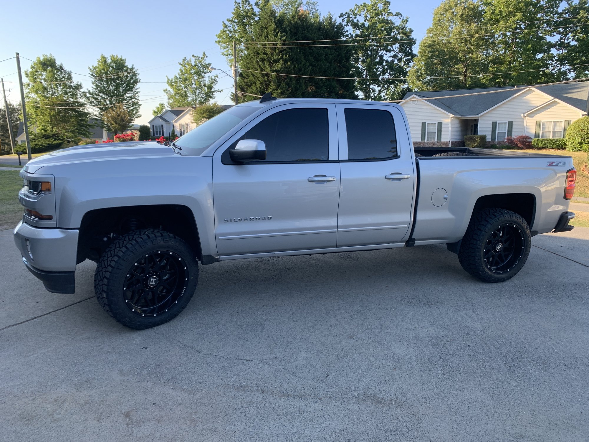

Great looking truck man. What wheel/tire setup you running? Happen to have any side profile shots?
Hostile Stryker 20x12 35x12.50 nitto terra grappler m/t kind of the only other side picture I havefa15a28351e8a5865927757728d88f32.jpg
