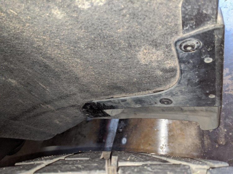

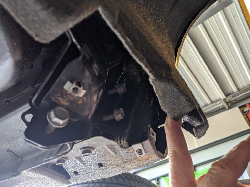

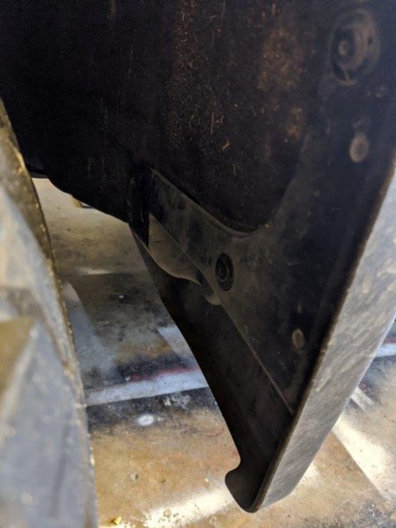

It is slightly different.  I just did mine yesterday and its easy. Took about 20 minutes without really knowing what I was getting into.  I did not cut my flaps.  I just removed the bracket that is behind the flap and drilled two holes vertically, and ziptied it back to the frame behind it.  I gained about an inch, and I dont think you can tell anything from the outside.
You can get a ziptie around the plastic behind the wheel well plastic without taking anything off. Use a serious ziptie,  Turn the wheel so its close and you can use something to pry the fender away from the tire, while pulling the ziptie to hold it in place.  Got a little less than an inch up front now.
This is really great to know. Thank you for the write up and the pictures. It will be very helpful.
