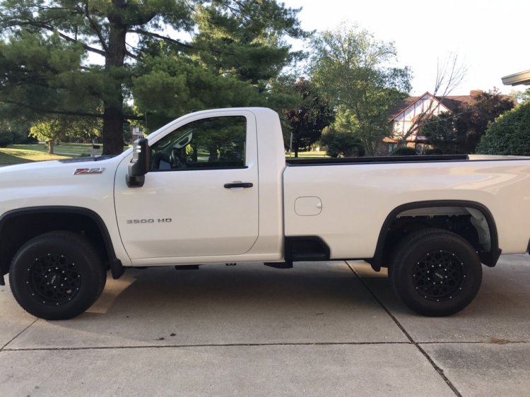

Did some research if your truck has the factory 245 tires the overall diameter is 31.5”, the 265 tires are 31.6”.  Now the 285/65r18 will be 32.6” and the factory 275/70r18 will be 33.7“.  Below is a picture of my truck with the factory 18” tires with aftermarket wheels
