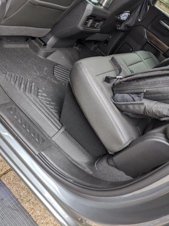

I installed this under the passenger seat. https://www.amazon.com/gp/product/B019Z3RFGY/ref=ppx_yo_dt_b_asin_title_o06_s00?ie=UTF8&psc=1
Tapped into the wires coming down the channel under the door sill. I replaced the door speakers with a set of rockford fosgate's and the overall improvement is pretty good. The sub I linked fits nicely under the front seat, but does interfere with moving the seat all the way back. One of the steel bars under the seat catches on it just a bit. If I tried, I could probably find a way to mount it where it doesn't interfere, but I just haven't had a need to yet.

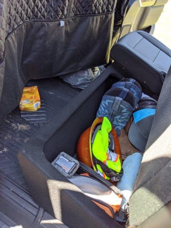

Built mine.  Stock storage thing is junk.  10" sub rounds out bose system.  I can give some rough dimensions later.
IMG_20200508_082831_MP.thumb.jpg.c5916de7b8a4639ccfe9d6b42756f057.jpgIMG_20200508_082840_MP.thumb.jpg.1f2b7642081abb3d6da1ad3c3ed5dc11.jpgIMG_20200503_153306_MP.thumb.jpg.e19071c14dcbfc1cb6566c5cd1c5f289.jpg
