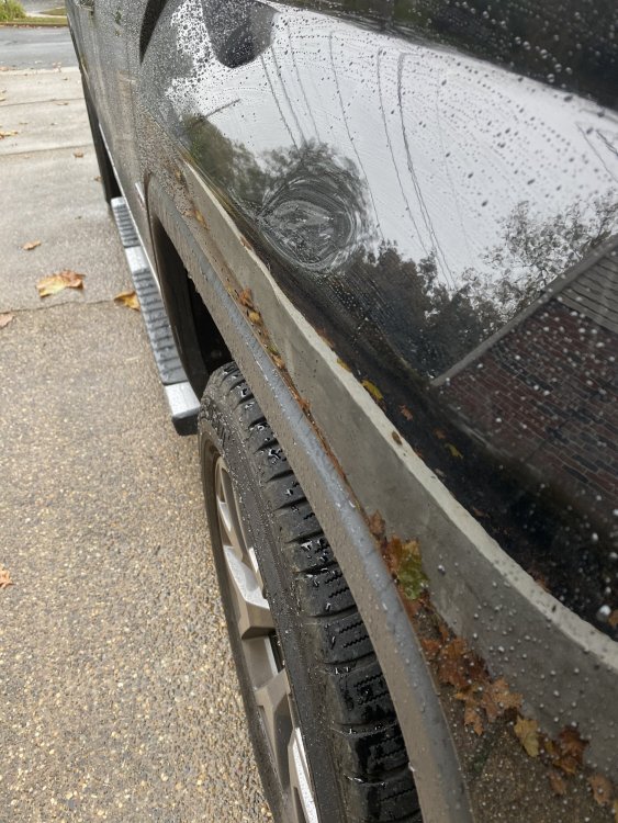

Want to get PDR for the dent. Not sure if there is access through the wheel well. I took out the liners once before but don’t remember how much access there is. Anybody familiar with this area?
That’s front passenger side if it matters.

Through the tail lamp is where that one gets fixed.
Had a bird hit in that area not quite that deep though.
That looks like it has a crease in it. Not sure that one can be done by PDR
Maybe

If its in the bed the top plastic cap will need to be removed just be careful when removing so you don't break the clips. I had some pdr done on my 14 and thats how he accessed it.

May be able to reach it from under wheel liner or worse case may have to remove radiator coolant tank and drill a small hole to get tool in.

Thats the front passenger side
Yes, they can access the dent from behind the coolant overflow tank from inside the engine compartment. Had dents taken out of both my 14 and 16 the same way from a good PDR company.
Ouch!  I would stop by a few body shops on my travels and get their cash price estimate.  I've had success stressing that I'm in no rush and cash flow is poor.  One shop had an employee that needs extra money and does small repairs during his lunch break and after hours.  Another shop introduced me to a home based body repair shop run by an ex-employee.  With some patience and persistence you will take most of the upset out of this and future whoopsies. ?
