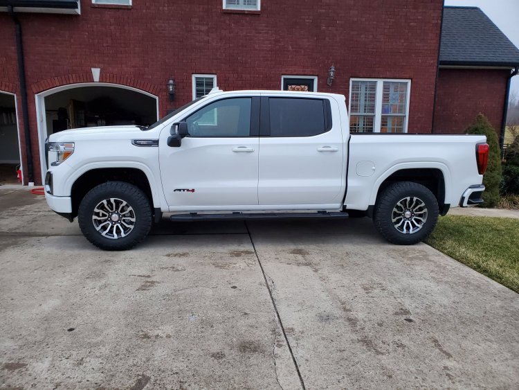

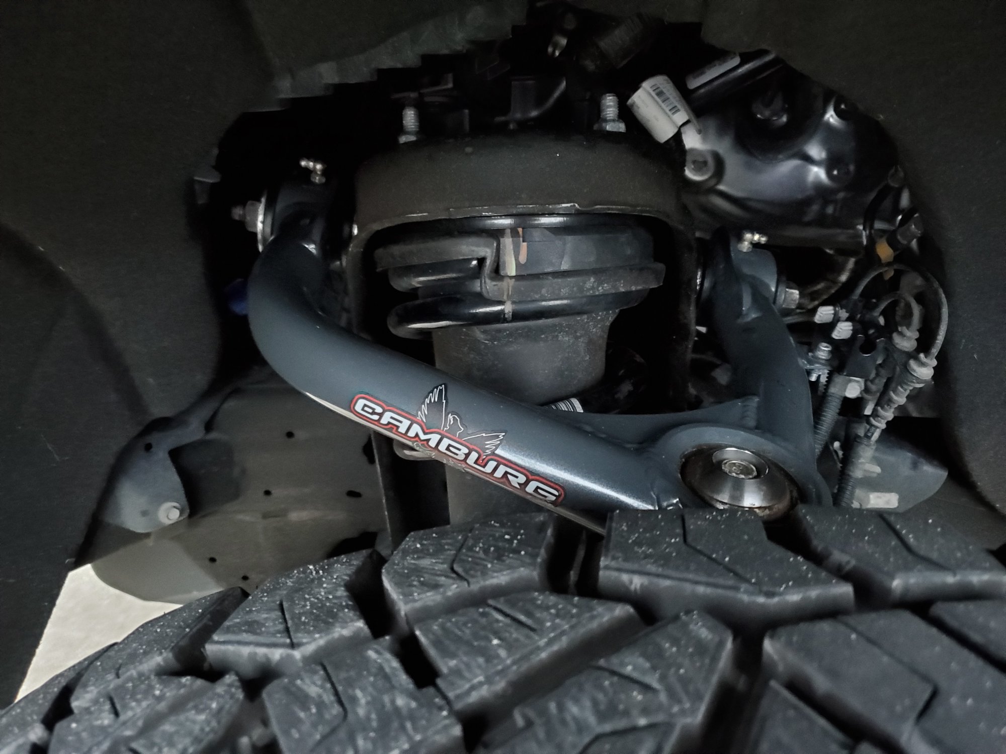

I just got a nice Christmas delivery! I know what I am doing over the break! These will go on in combination with the Zone offroad 1.75" AT4 leveling kit. I will take before and after photos as well.

How it's going after Zone Offroad 1.75" AT4 leveling kit, Camburg upper control arms, and new Ridge Grapplers
Camburgs are great....the uniball is just not preferred for daily drivers due to having to replace it every 4 or 5 oil changes.  There is no boot to protect it from dirt and water and the cap they sell only covers the top while leaving the bottom wide open.  I think Icon's delta joint is best of both worlds.
