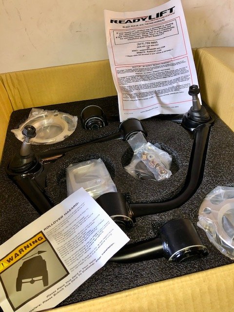

So when I bought my 2020 1500 RST crew cab 4wd duramax I had the dealer install the GM 2 inch lift. After about a month I had the same dealer install the ReadyLift Trail Boss 1.75” Level Kit which comes with upper control arms and some spacers...now at FULL TURN only Left or Right I’m getting this clunk noise coming from what it looks to be the half shaft(cv boot)??? Not sure...has anyone else had this issue? Im starting to think the dealer didnt install the NEW half shafts that came with the GM 2inch Lift kit maybe? And just ran the original ones?? Im not sure but ANY help would be appreciated...TIA!
