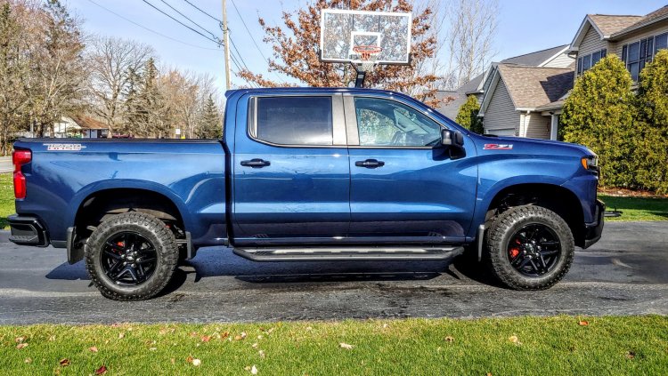

Here is mine with a 1" moto fab lower strut spacer and the stock uca's. I have 5,000 miles on mine with no issues. With this setup I still have 3/4" of rake.
