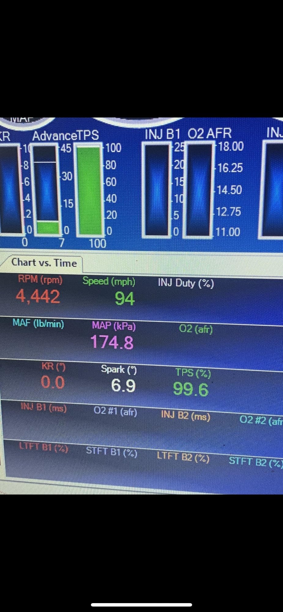

8 hours ago, flyingfool said:
so... 84% is 100% wot?  i'm guessing whats left on the gauge is reserved to either TM, IDLE, or TC
no it should show it on the log if its actually %100. This is one of my logs with a gm l86 tb on stock l83 computer. Dont know what exactly my tuner did to achieve this but it does show it can be done and this is at 500+ rwhp
