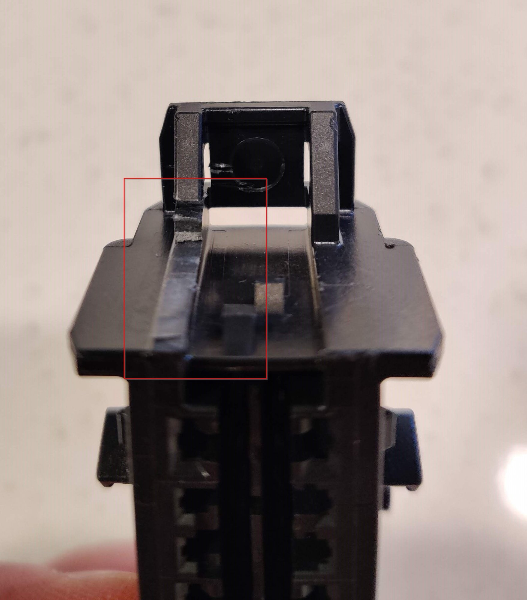

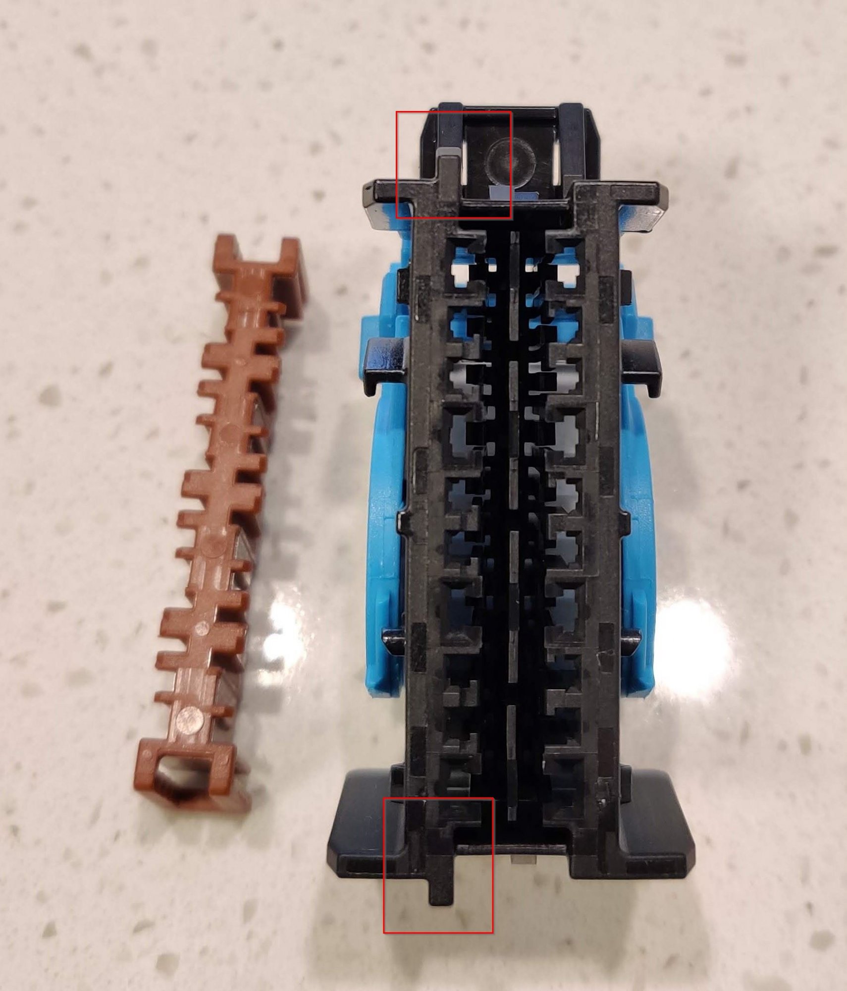

For the physical connector that plugs into the X7 socket on the junction block you'll need: Aptiv 15547106 (because the OEM P/N is no longer available)
The connector is the right design, but it is physically keyed differently. The correctly keyed connector is out of stock everywhere, but with a razor blade you can cut off the second key that prevents it from fitting.
Here the connector is before I cut it:
Here the connector is after I cut it:

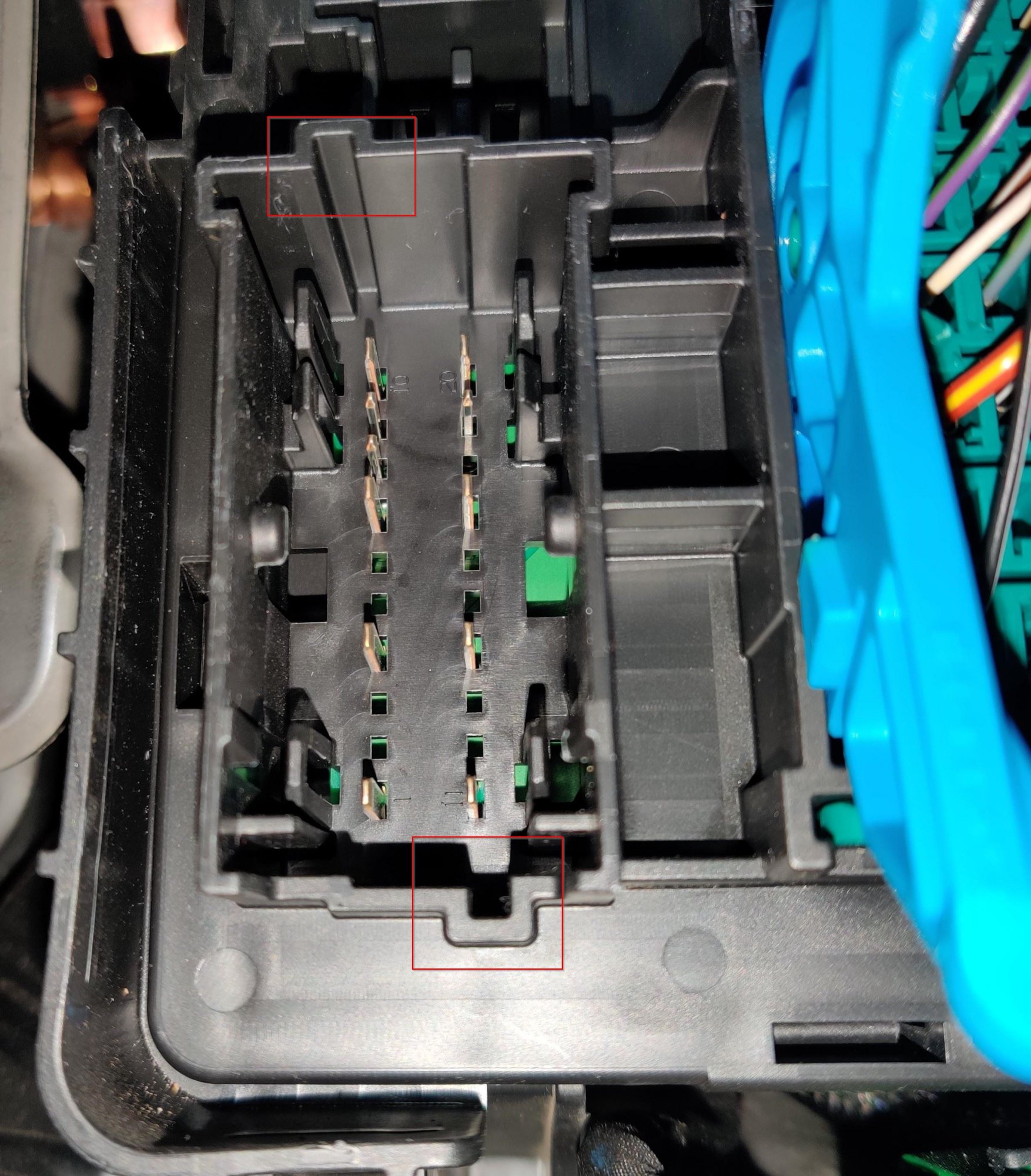

Here is the cavity in the junction box in the driver footwell:

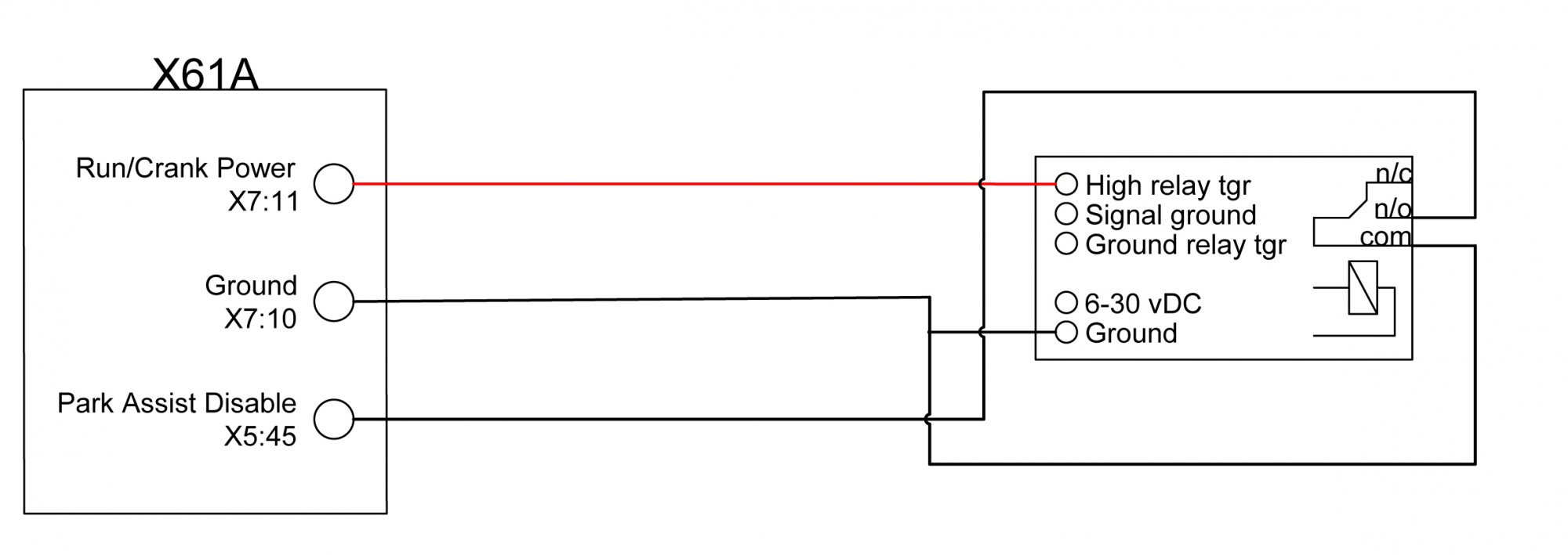

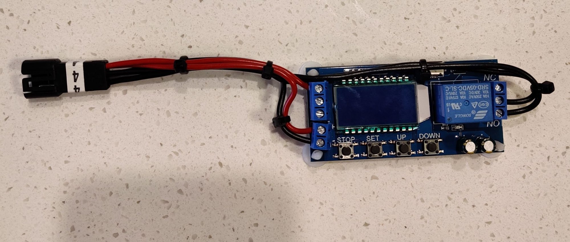

Next you'll need to wire up the relay module. I chose to use a connector here so I could easily connect and disconnect it. When this module is disconnected the system works as it does from the factory.
Here is the wiring diagram I whipped up:

4. Time delay relay configured for close on power, delay for off at 2 seconds
