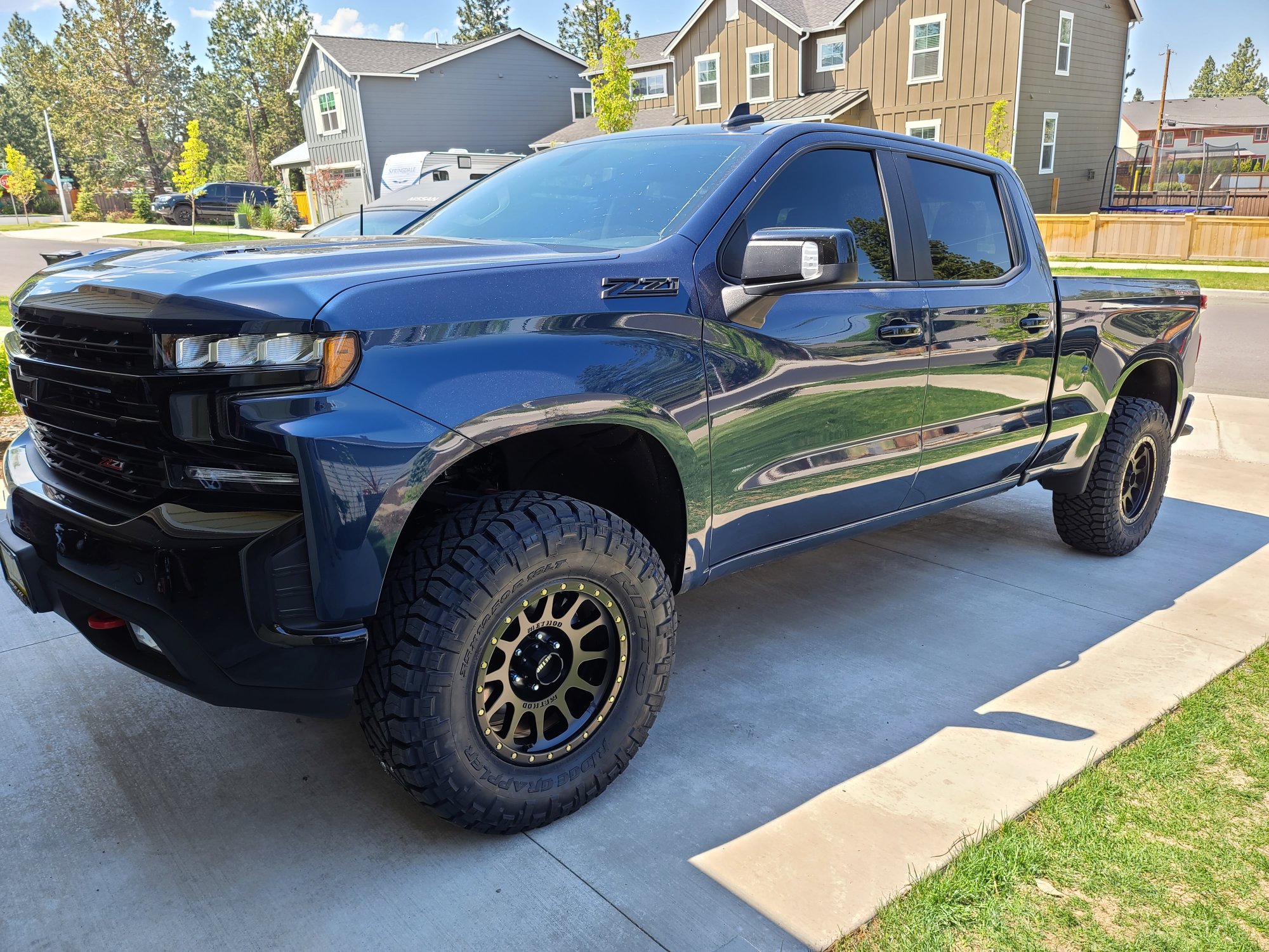

So after reading countless posts about if they do or don't and the mixed bag that came out of all of it I decided to just go for it.
Here's the jist of what I did:
-Zone off-road front level with control arms https://zoneoffroad.com/products/175-in-leveling-kit-2019-2021-chevy-silverado-trail-boss-gmc-sierra-at4?variant=39431680295000
-Method MR305 NV 18X9 -12 OS
- Nitto Ridge Grappler 35x12.50x18
Zone kit comes with separate plates for 1-3/8" or 1-3/4" lift. Zone suggests 1-3/8 for TrailBoss and 1-3/4 for AT4.
*MINE IS SET TO 1-3/8

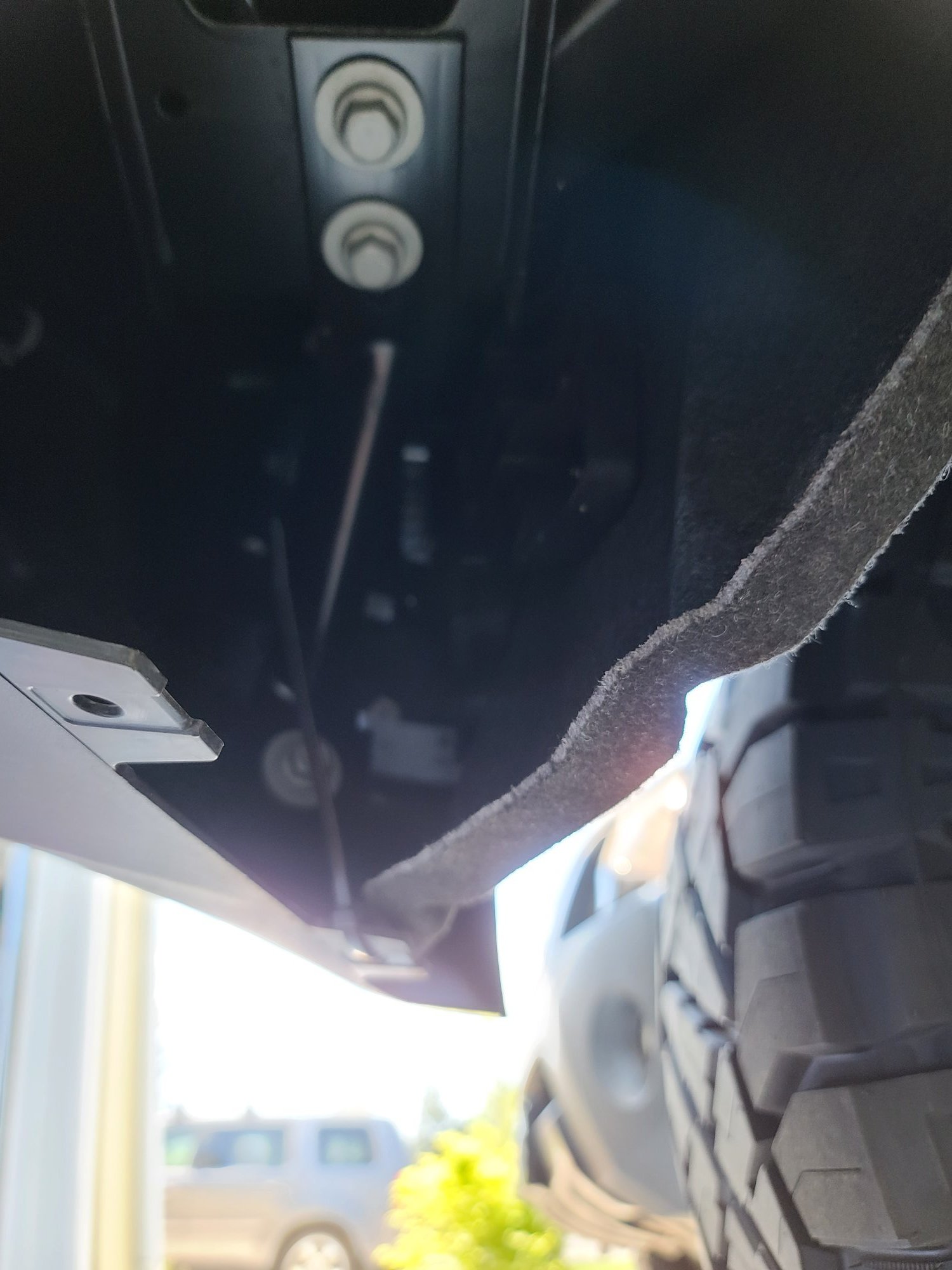

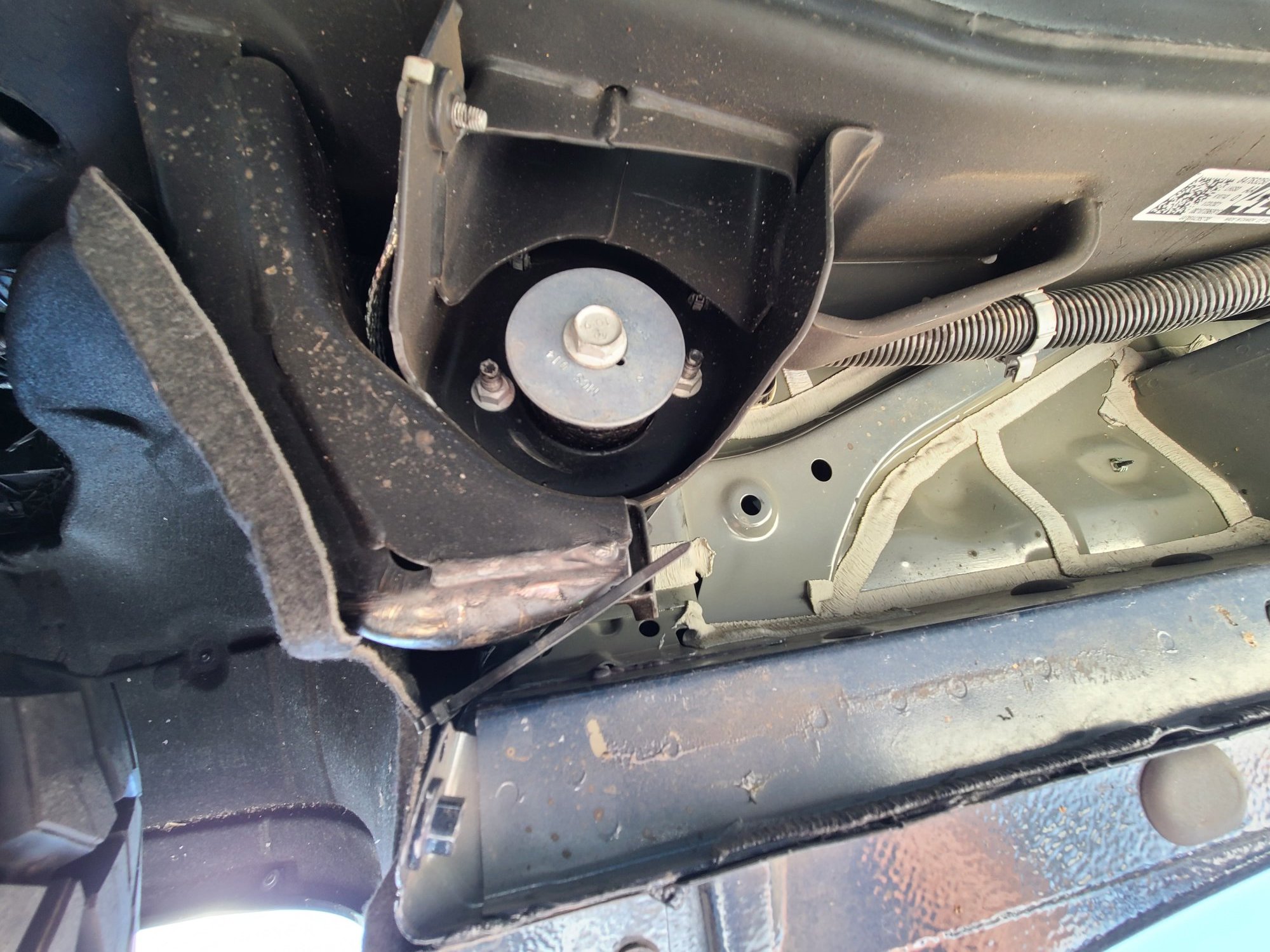

Back side (firewall side) - I removed the lower bracket (4 - 13mm bolts) that is for the mud flap and lower screw fit fender liner. Zip tie thru bottom screw hole in the fender liner back to lower frame hole (pick a hole any hole) and pull it back as far as possible pics 2 and 3.
Simple mods took less than an hour to accomplish all of it. Full 35x12.50x18
Any questions or other pics you want let me know.
