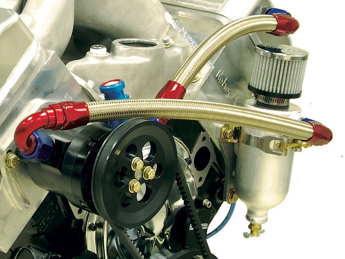

Too much crankcase pressure, I imagine you have a cold air intake, where did you route the crankcase breather element?(maybe a picture), also are you running the 0W-20 recommended oil? Now the compression test would be a good idea. Also you could think about a vacuum pump system.

any one make a breather that replaces the oil filler cap?
yeah I found a guy on youtube that had did a k&N filter for the oil fill cap and as well as for the other valve cover. I am going to install those. But I am still not sure why the catch can has so much oil in it.
