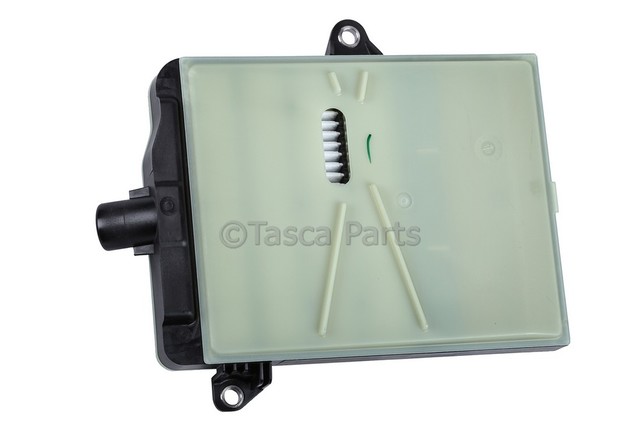

Dealer is wrong.  Plastic housing with paper/fiber filter media inside.
2017-2020 GM Transmission Filter 24291343 | TascaParts.com
Edited by newdude
And you can clearly see the paper media inside it (the white fins in that open hole):
Edited by newdude
