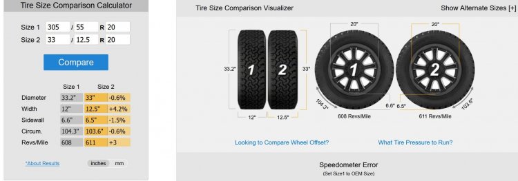

Thanks for the info. I have a new to me 2015 Silverado with 128k miles that needs new shocks, so my search has led me to lift/level options that include the shocks. That is basically four options: Bilstein, Eibach, Rough Country and this Belltech kit. I talked to Belltech on the phone, and was impressed with the knowledge of the tech on how these struts were developed for the GM trucks.  Can you post more angles/pictures of your truck with this lift? Do you think you could fit bigger tires? Are those 305's bigger than a 33/12.5?
Bigger, yes, but not as wide. See here:
I will get some more pics for you.  I can easily fit 34" tires with this lift. Probably could squeak by with some 35s.  I could easily go with 13" wide since I have 1.5" spacers.  The 305s look small now. lol
