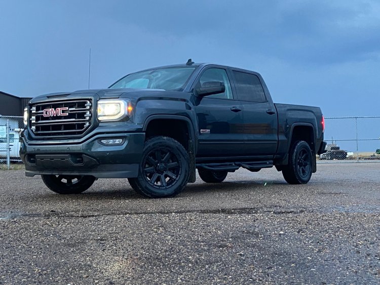

Hey guys, I have a 2017 GMC Sierra 1500 (6.2) and I’m having trouble filling the truck with fuel. It clicks off the pump handle repeatedly, and it is a huge pain to fill the truck at the pump. I’ve checked the breather tube for the fuel neck to see if it’s plugged and it doesn’t seem to be plugged. And my truck is the year where they have have no twist on fuel cap,  and i drive a lot of gravel roads daily, so I’m wondering if there is a breather filter I have to clean so that the tank can breath properly when refuelling. If anybody has an tips how to fix this it would be appreciated!
