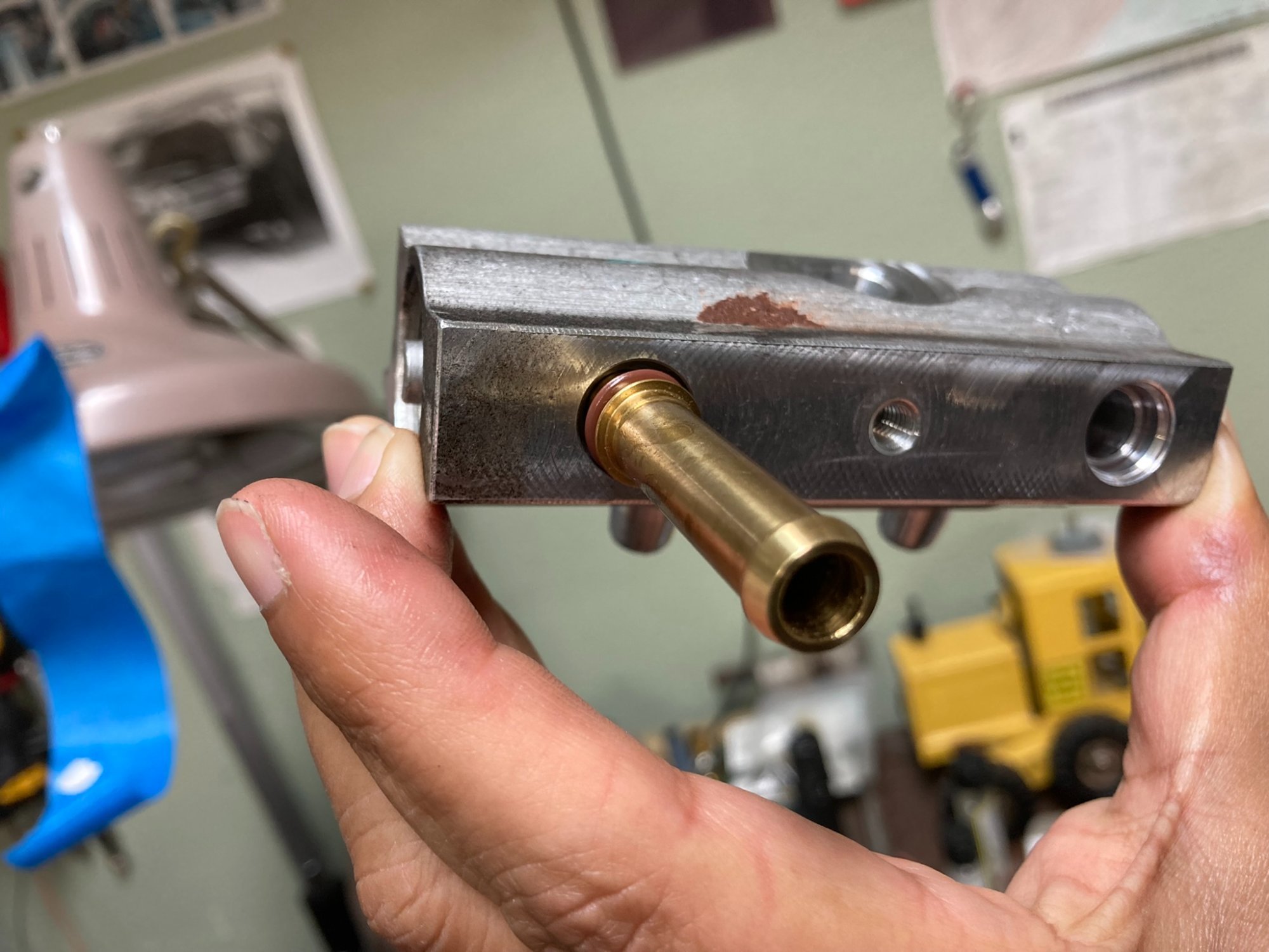

3. Remove the cooler block, inserting some poly line in the cooler port on side of transmission towards front of vehicle.

I really can't say when the fluid turned cleaner as mine only had 5k miles so it was still very clean.  I highly suspect GM used the wrong fluid (see above post) and that is why I changed it.  I used 20 quarts to make sure it was a complete flush.  Jegs had the best price with free shipping if I recall correctly.  I have the thermostat delete kit in mine so it was easy to flush.  One hose barb in the return port and I was good to go.  I also bought an adaptor that screws into the check fill port of the pan and I was able to use a drill pump to pump the new fluid in.  Shifts improved immediately after the flush.  I had my doubts when doing the flush, but I guess GM did have some other fluid in that "flo tech" flush machine.
