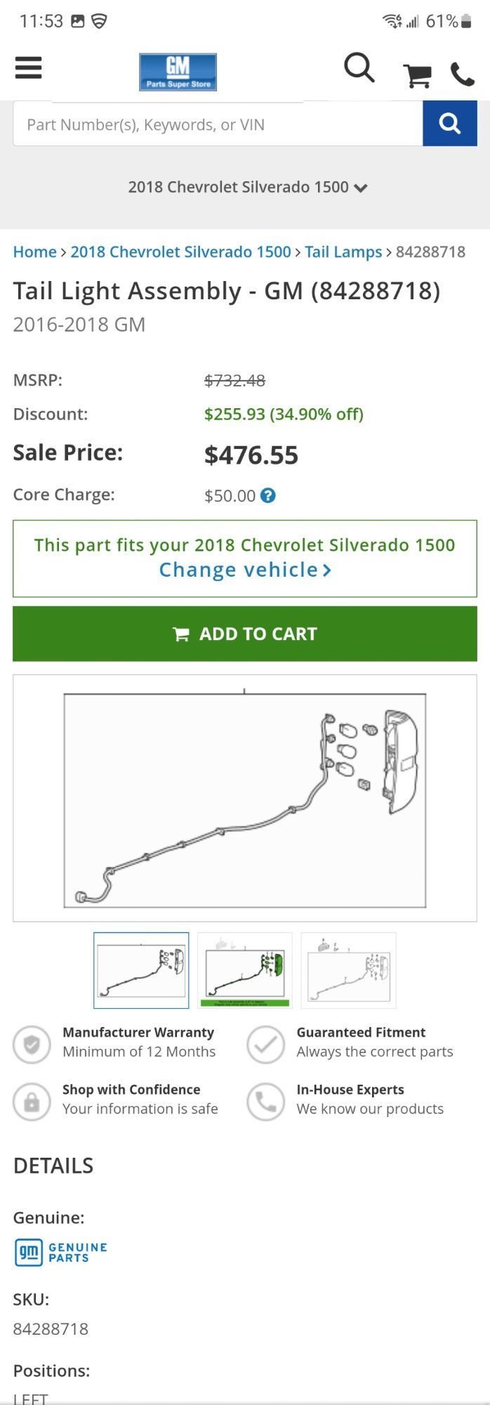

I've got a 2018 Silverado LTZ with factory LEDs. Lately I've been getting a hyper flash when using my left turn signal like I have a bulb burned out, and a message in the DIC saying left rear turn signal failure. But it's not completely out. It just kind of flickers and isn't as bright as the other tailight. Took it to the dealer, they're saying I need a whole new assembly and quoted me $1k 😮
What other options do I have? Anyone have experience with this issue?
I had this issue with my right turn signal on my 2018 LTZ. Luckily I was still under warranty at the time. Unfortunately the whole unit needs to be replaced. You could check and see if you can find one on line and replace it yourself wouldn't be that hard.

Check with @Frankielozano214 I think he is selling a set of the LTZ taillights for $480 and then you would have a spare for the other side just in case...
https://www.gm-trucks.com/forums/topic/246248-fs-oem-ltz-and-denali-taillights-with-oem-led-harnesses-480-shipped-each-set/
