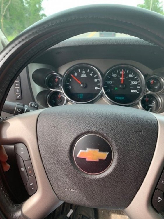

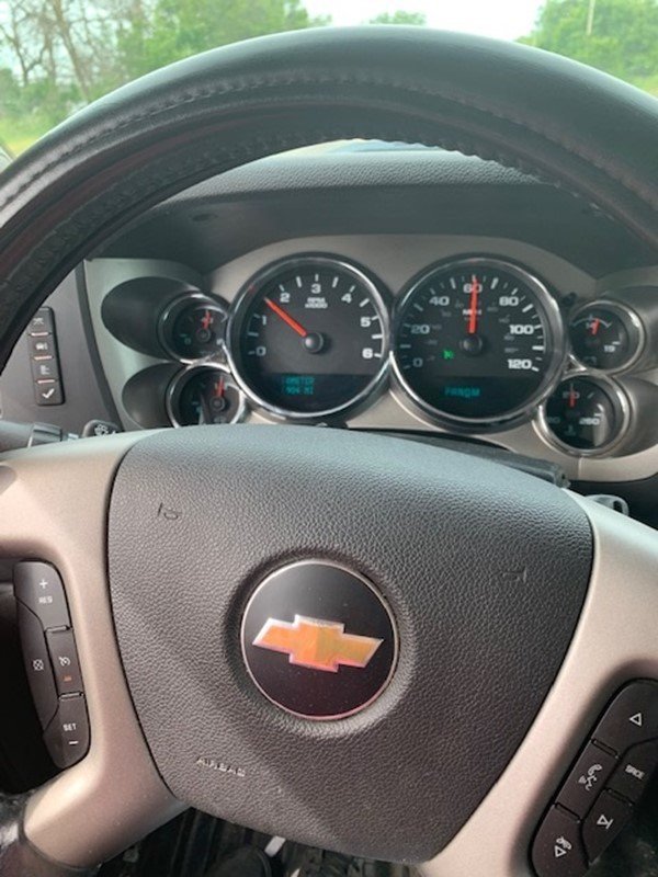

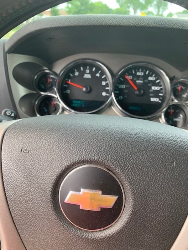

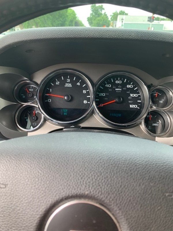

just to show how my truck behaves  here are 4 pics from my commute home from work.  its only a 15 mile commute at 60mph for 10 of the miles
Pic 1 first pic i am at operating temp - 60 mph - 1500 rpms  oil pressure 42psi
pic 2 - further down the road - oil at 40 psi
pic 3  - in city - 40 mph and oil at 38psi
pic 4 in town at stop light - 22 psi

Bleepster, good visual pics of just what I was referring to.  My mechanic told me not to worry, even the 22psi was well above GM's specs.  So I'm not worrying.  I'm still seeing 30 and sometimes 22 at idle, 40 hwy.  Thank you for your responses.

I've had numerous GM trucks across three different generations, both personal and company. They all seem to do this, averagely hover around 40, move between 20-60. I wouldn't worry about it personally. If the gauge pins out or barely reads, then I'd be interested in finding out why. But if it is steady and occasionally bounces around and still is a healthy pressure, then its no cause for alarm.
