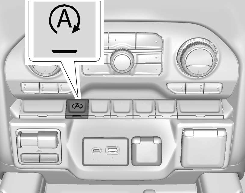

Any of these apply?
Auto Stops may not occur and/or Auto Starts may occur because:
. The climate control settings require the engine to be running to cool or heat the vehicle interior.
. The vehicle battery charge is low.
. The vehicle battery has recently been disconnected.
. Minimum vehicle speed has not been reached since the last Auto Stop.
. The accelerator pedal is pressed.
. The engine or transmission is not at the required operating temperature.
. The outside temperature is not in the required operating range.
. The vehicle is in any gear other than D (Drive).
. Tow/Haul Mode or other driver modes have been selected.
. The vehicle is on a steep hill or grade.
. The driver door has been opened or the driver seat belt has been unbuckled.
. The hood has been opened.
. The Auto Stop has reached the maximum allowed time.
If equipped, the automatic engine Stop/Start feature can be disabled and enabled by pressing the switch
When LED is illuminated, the system is enabled.
