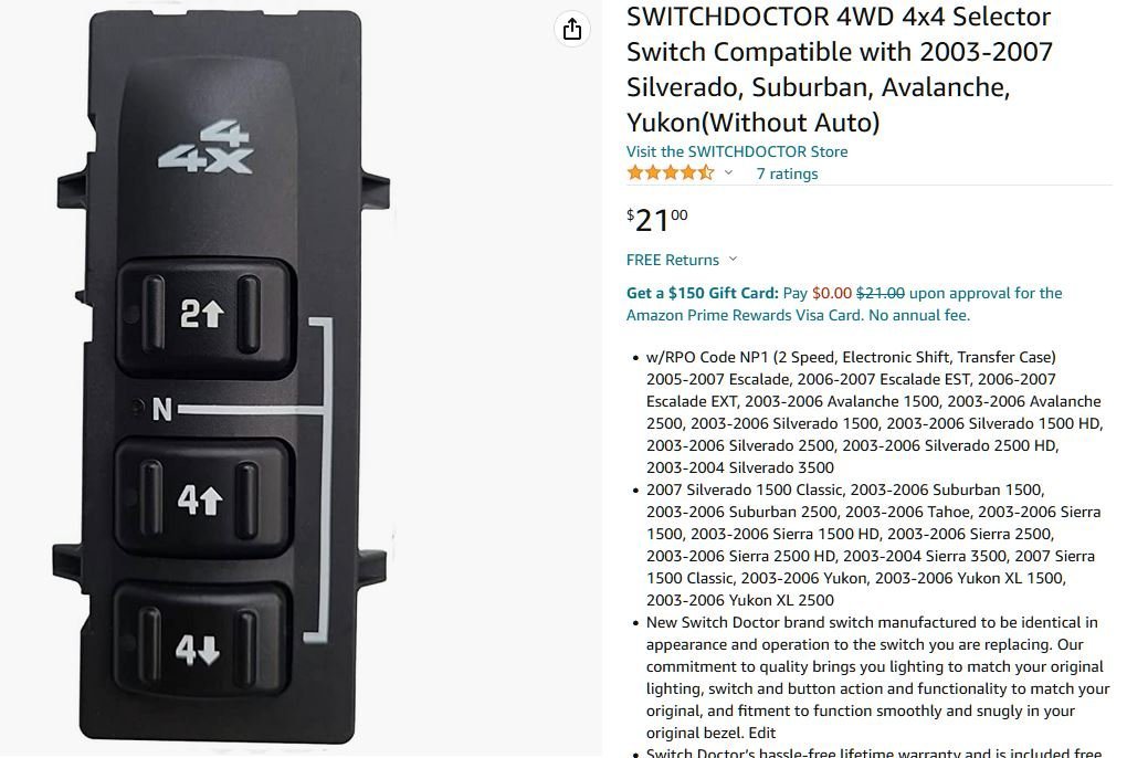

Try replacing the switch first, it's a real failure point and only about $20.
My truck had similar symptoms, so I got a new switch and that was it.
Check out SWITCHDOCTOR on Amazon for the correct switch for your vehicle.
