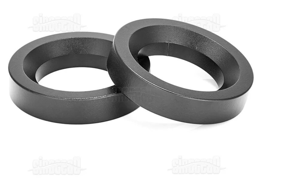

I wonder if a 1" preload spacer fits the Bilsteins.
No idea, I'm just going to leave it as Is for now. I'm happy with the improved ride quality.
