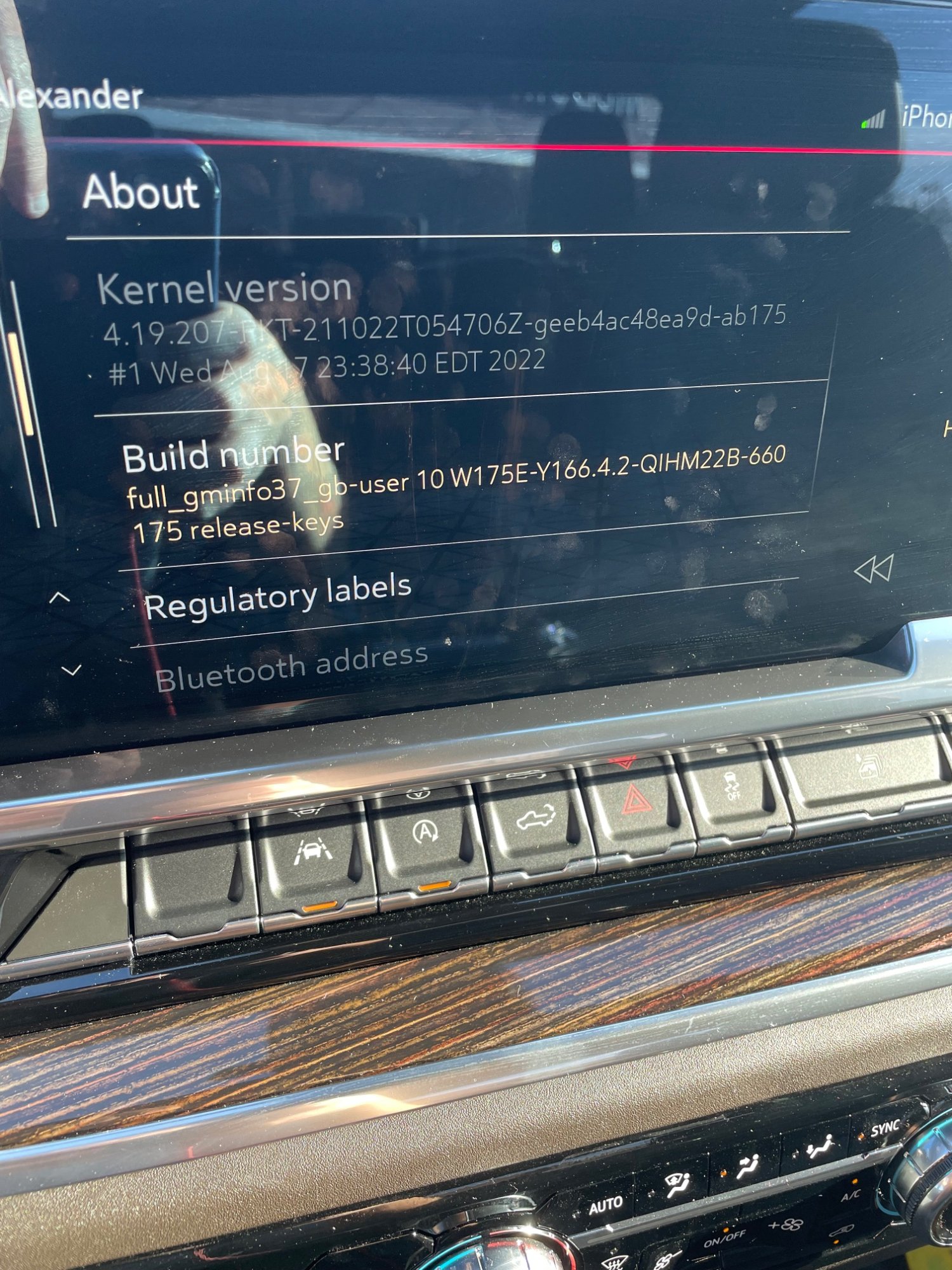

Most recent radio software should be W164.  This addressed the static issue.  I did mine a few months ago, no static.  I couldn't get it to go OTA so had to take it in.  The DRL recall came to me OTA however.
Pic for reference.  Go to Settings, About and then look for Build Number.  The second "Wxxx" is the software number.  If its lower than W164 its the older software.

@newdude, thanks for the info. I’m running version 163 right now. I took it to the dealership for the recall last month because I wasn’t getting the OTA update and told them to update my cars system to the newest version. They took care of the recall but I’m bringing in my truck again because the software was never updated and the static is still present along with the issue of not OTA updates are being received.

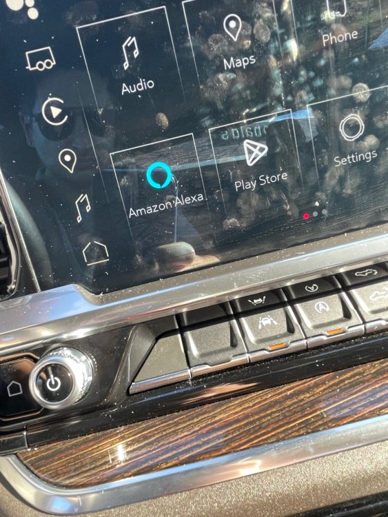

Update:: I took my vehicle in to the dealership last week and they were able to download the latest version. Not sure though why I never got it OTA. My speaker static is now gone but with the update I also got the Alexa functionality now and it works. I was wondering if anyone was able to get the new update with Alexa OTA just to see if the whole OTA update thing is even working with other owners.
I checked for OTA updates yesterday. Nothing. Says last update was 10/05/22 an that was before I bought the truck. That update could have been at the dealer for all I know.  No Alexa app as well. I still show I have the DRL recall as incomplete. It says that could be done via OTA. That recall came out 12/8/22. I have not received anything in the mail on the DRL recall to date.
Makes me wonder if there’s something wrong with GM’s OTA system because there’s definitely updates available. I too, couldn’t receive any updates without taking it to the dealer. Attached, is my card current software version and the Alexa functionality for reference.

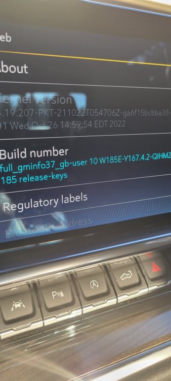

20230321_174602.thumb.jpg.65d850a14e523b54a5d7aad581892094.jpgI too was not getting OTA updates. Took the truck in today they updated the infotainment system to the latest version which is now version 167.4 they had no answers as to why I'm not getting updates. They are thinking this might fix the issue 🤞
