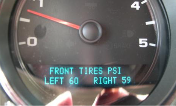

this 2013 silverado has the full DIC as pictured below.  however there is no "RELEARN" option - why?
when we cycle we can see this but instead of 60 and 59 all we see is "--"  for front and rear

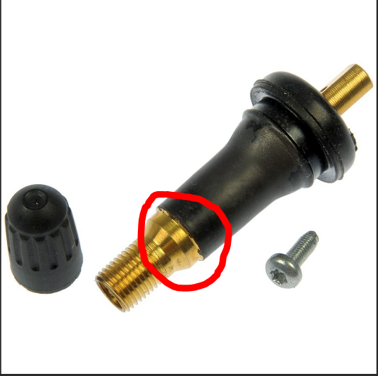

also - his valve stems like like below - the chamfered area according to my research indicates TPMS (circled area below)
Alright.  We have an LT and LTZ in for service.  The LTZ has the ability in the DIC to initate the relearn.
The LT does not have it.   Appears to have been a trim specific feature on these year trucks.
So.  You will need a programmed key fob or a scan tool to initate a relearn.
