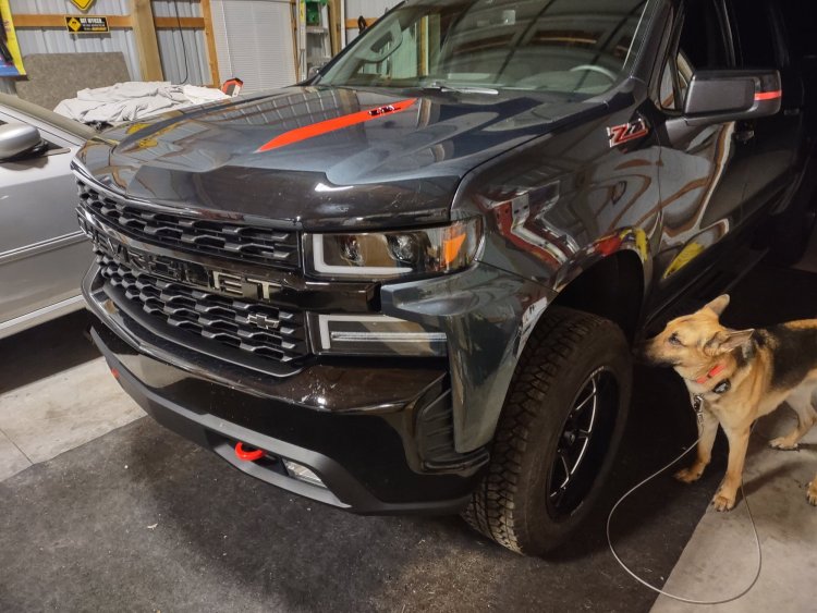

Are there any headlights worth upgrading to with this grill or should I do the full grill swap?

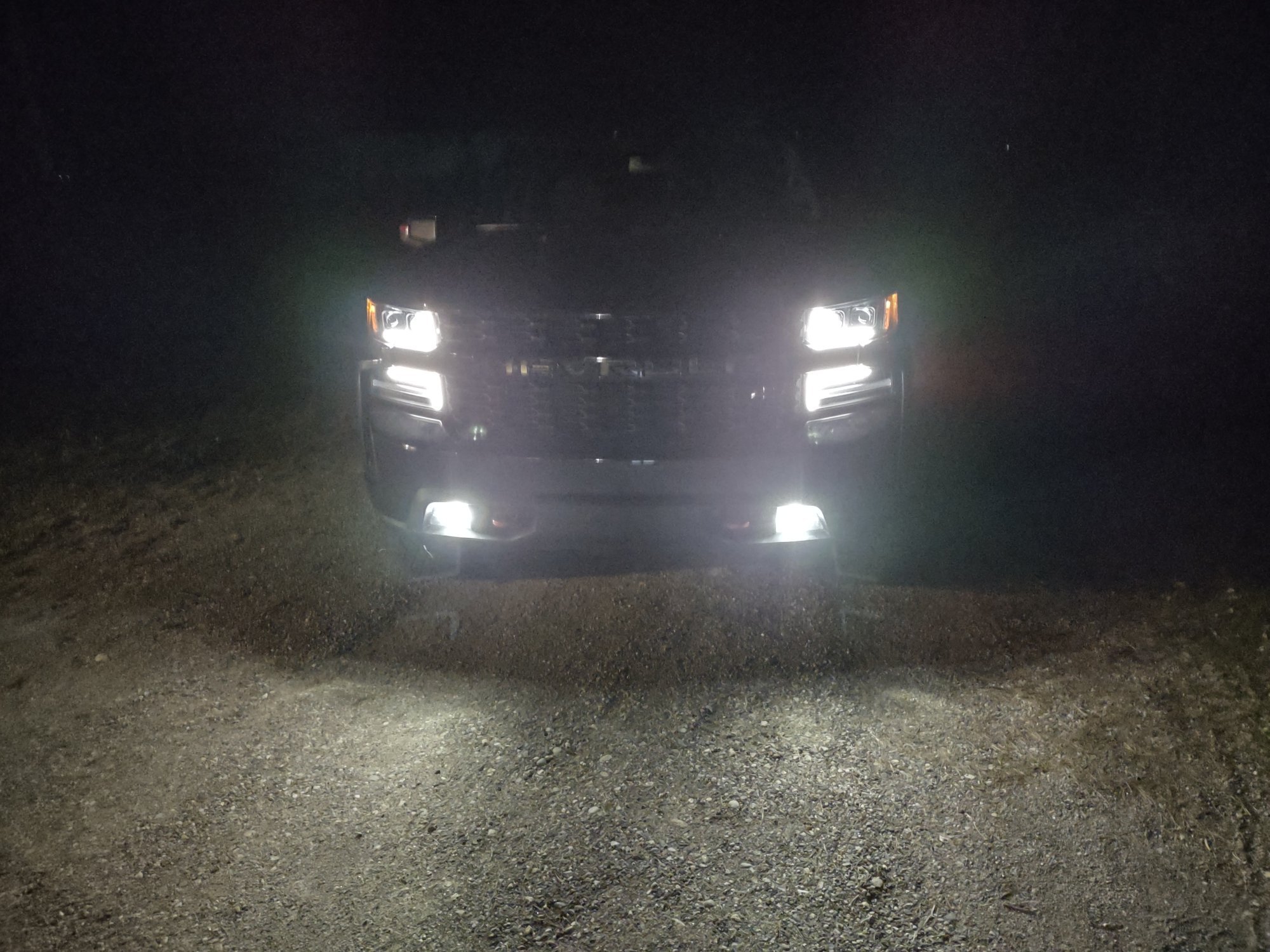

I also have the high 6 mod so all 4 headlights and the fogs stay on with the high beams.

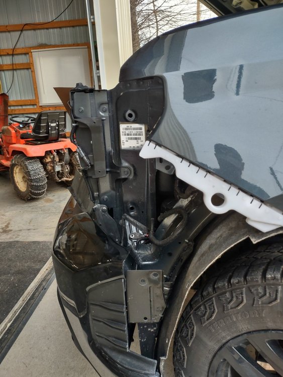

You have to pull the grill which wasn't too hard. The real pain in the ass is the front fender extensions. One video I found online said you could pull the headlights with them in place, but you can't since they cover part of the headlights. There's also a hidden bolt you have to pull back the fender liner to reach. The nerve wracking part is popping out the top part as it's held in with snap tabs into a white plastic piece that's bolted to the fender. Make sure it's warm when you do it so it plastic has more flex to it!
