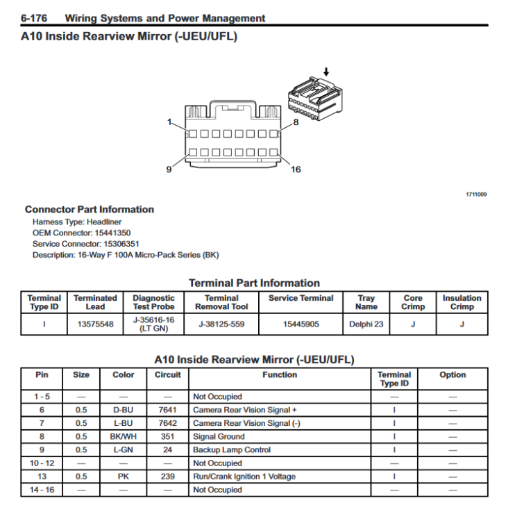

Hello, I don't know if this is the correct place for this.  But ill give it a shot.  I have a 2019 Chevy Express 2500 Van, and I'm looking to mimic the rear view camera image down to the head unit.  I need to know what two wires out of the 5 wires that goes to the mirror that supply's the video input.  I would like to have the video on with a push of a button on the head unit, so when im driving down the road I can see behind me.  Hope someone can help me out here.
Wow Zeker,  Thank you so much.  I have been looking for this for months.  I added it to the thread if anyone else has the same issue.

Would this make sense?  If I totally removed the 9 wire from the harness and jumped pin 13 to 9, wouldn't that keep on the rear camera when the key is turned on?  This is my end game

For anyone that wants to duplicate the OEM camera to the head unit, this is what your going to have to do.
Buy this- https://a.co/d/74nXhUK
*Tap into pin 6 and attach it to the wire coming off of the part from amazon, this is your +
*Tap into pin 7 and attach it to the negative wire coming from the part from amazon, this is your -
*Now plug that wire into the head unit under rear camera
*Now tap into pin 9 and run that down to the head unit and connect it to rear camera 12V (this wire gets 12v every time you put the van in reverse).
