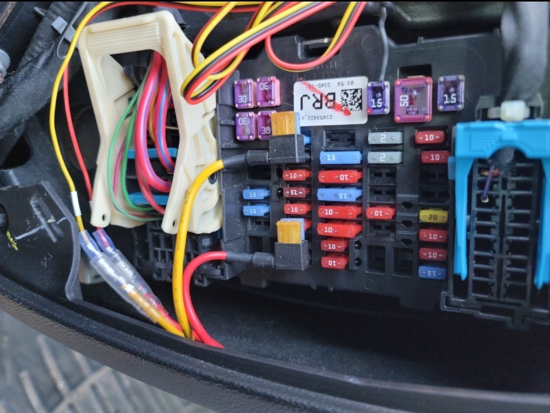

I'm installing a dash cam in my 2015 sierra 1500. The hardwire kit has a red and a yellow wired fuse tap. I looked on the driver side fuse box,but I'm not sure which spots they should go to.
Edited by mrg455
Your fuses are labeled the same as mine so you should be able to connect same way. My yellow is labeled ACC and is piggybacked to fuse #30 (SEO ALC). My red is labeled BATT and is piggybacked to #36 (Spare) The black ground wire is connected to the top nut just to left of the fuse panel.
One thing that makes this hard to figure out is that there is no plunger on door frame to deactivate the stuff that would have been with door closed. And when door is closed, the fuse panel is hidden by the door. One neat trick I figured out was that you can close the latch inside the door 2 clicks and that simulates the door being closed. It makes it much easier to probe the fuse panel.
Just wanted to mention that this works perfectly in parking mode and then activates into regular dash mode when truck is turned on for the drive.
