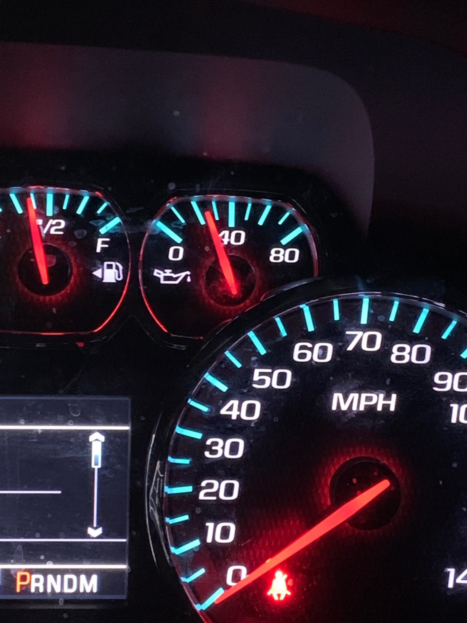

I’m trying to figure out if my trucks oil pressure is normal? At idle it sits well under 40psi but will stay at 40 during acceleration. I Attached a pic of it at idle. Thx
If that is at idle, perfectly normal. Same with the 40psi while driving. 2 stage oil pump, will increase/decrease as needed.
